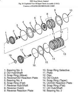

I am rebuilding my Jeep Liberty Transmission. My friend who is helping me is a professional mechanic but does not speak very good english.
We are finished except for one item that is broken that I cannot find anywhere. It is a clutch underdrive/overdrive reaction plate. My friend says that is the proper name and showed me a schematic printout from the jeep repair guide.
However, I cannot find a parts dealer anywhere who knows what it is or how I can get a spare one. I cannot find a part number for it and need this piece asap.
Is there anyone who can help me out here?
Thanks!
Tim
Oct 5, 2009 at 2:38 PM
KHLOW2008
  • 41,814 POSTS
Hi Tim, Thank you for the donation. You must be refering to Item # 15 in diagram.
https://images.2carpros.com/forum/automotive_pictures/192750_InputClutch02LibertyFig16_1.jpg

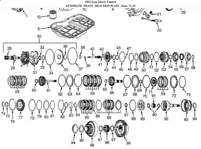

In this diagram it is Item 63. There are 2 different Part NO for different application. 4799108AC = 3.60/3.76, selective 4799108AB = 7.06/7.16 selective
https://images.2carpros.com/forum/automotive_pictures/192750_InputClutch02LibertyFig16a_1.jpg
