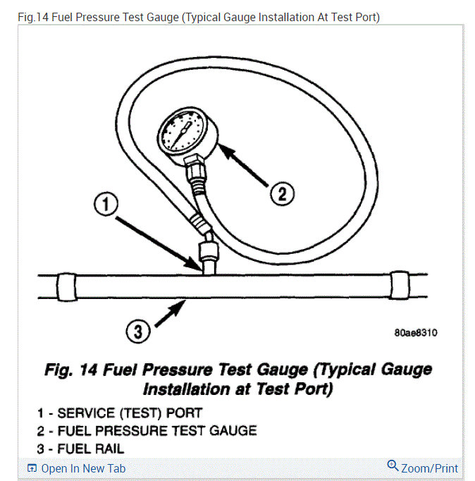

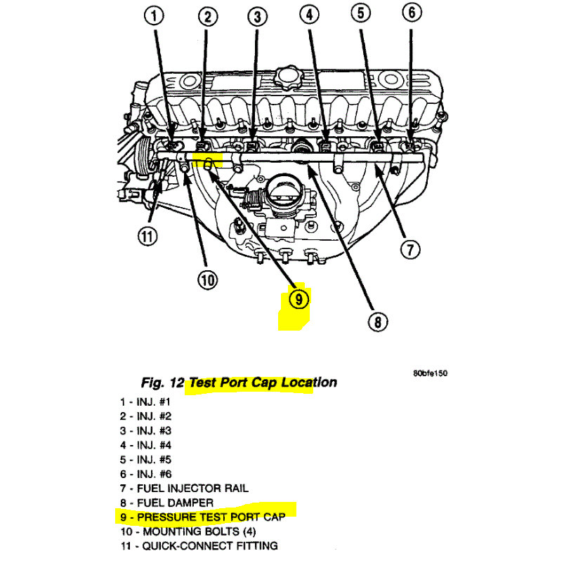

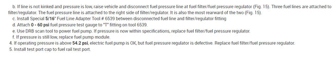

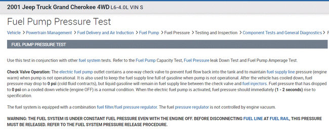

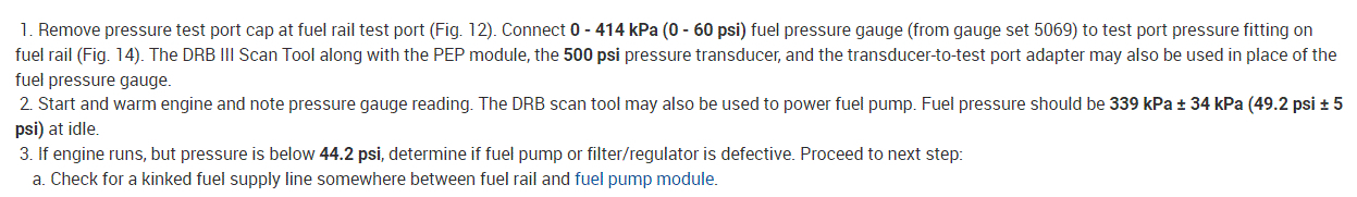

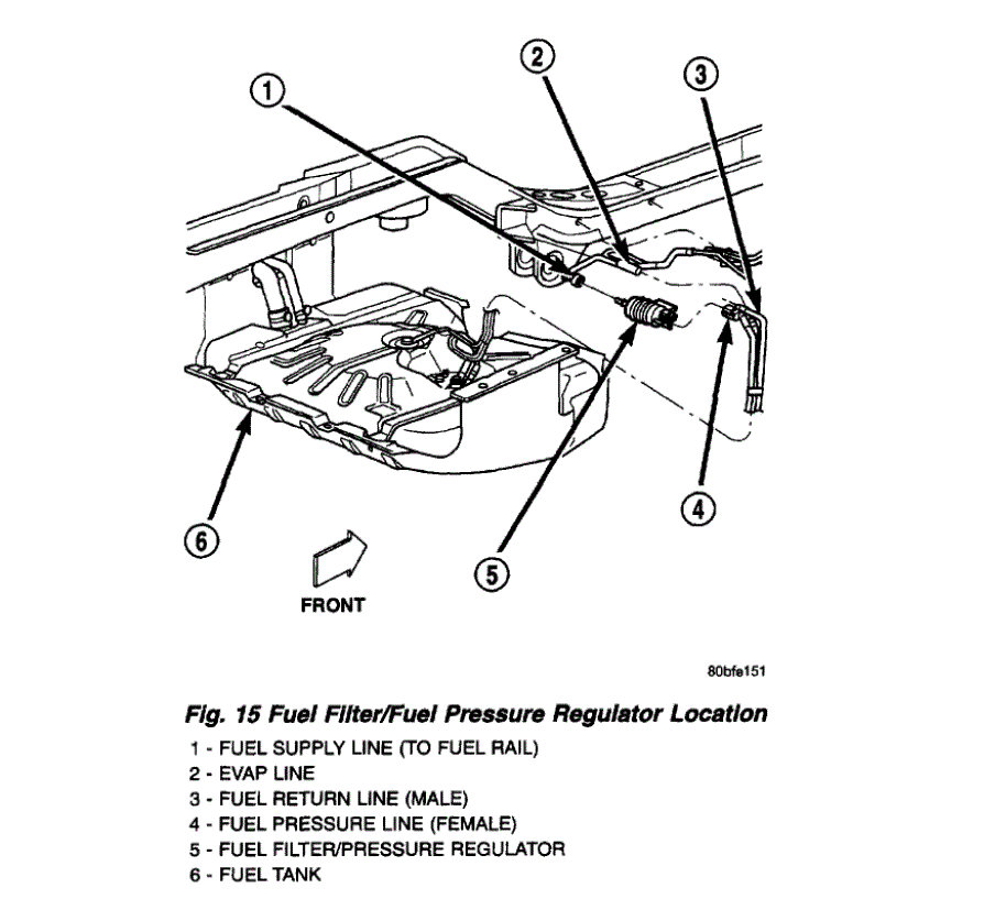

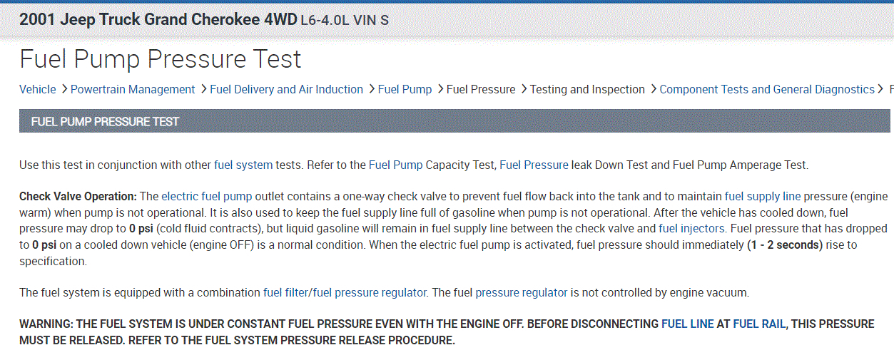

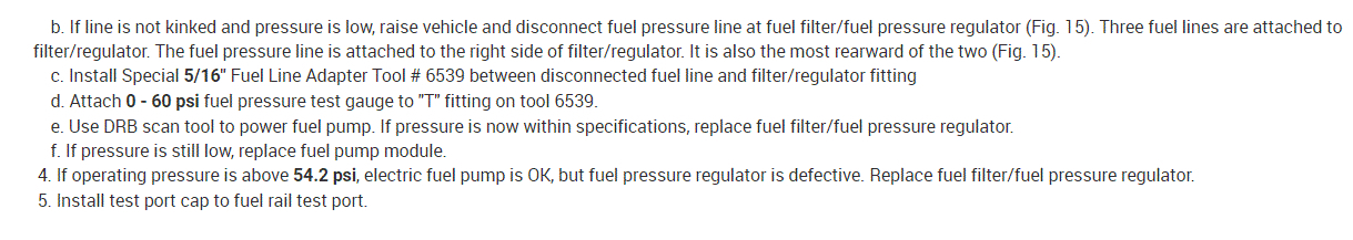

If you haven't already, make sure the fuel pump pressure is within the manufacturer's specs. Here is a link showing in general how to test fuel pressure:
One other thought. I noted that injector 3 was replaced. Is that something that continues, a misfire on that cylinder? Does it also include cylinder 4? This particular year (along with a couple before it) had issues with the cylinder heads cracking between the two cylinders. It's just a thought.
The pics below are the directions specific to your vehicle for testing fuel pressure. They include the specs as well. If you don't own a fuel pressure gauge, most parts stores will lend one to you.
