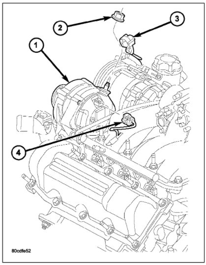

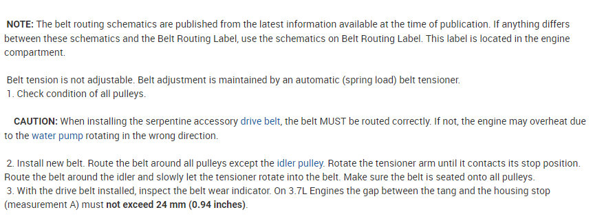

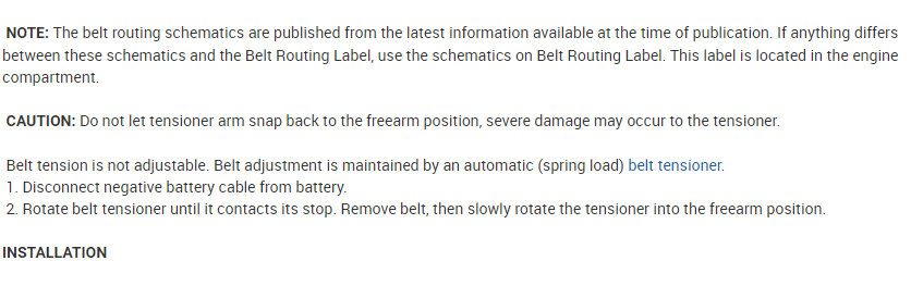

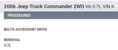

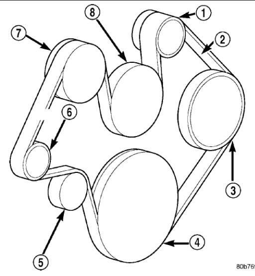

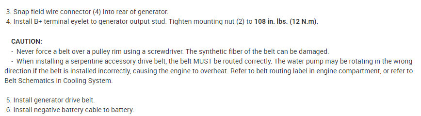

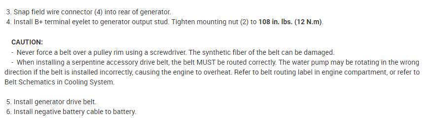

is it possible that a sensor is causing my alternator to quit working?
Jul 6, 2009 at 8:29 PM
DANNY L
  • 5,648 POSTS
Hello, I'm Danny.

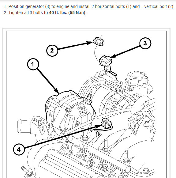

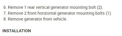

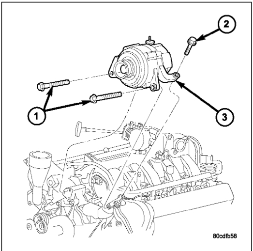

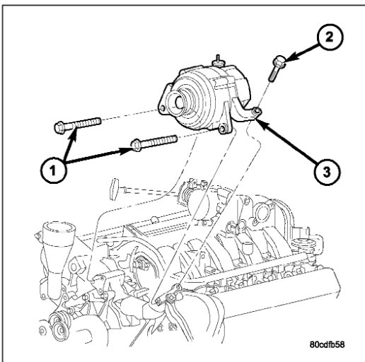

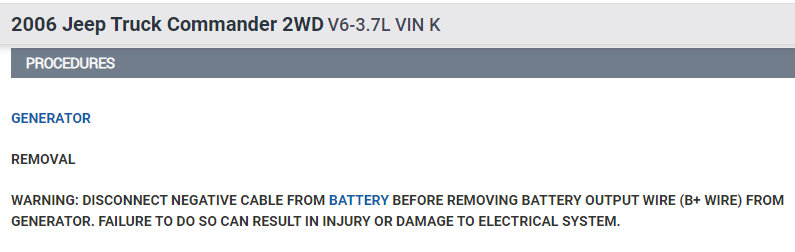

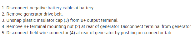

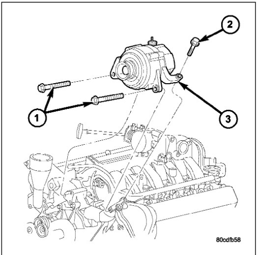

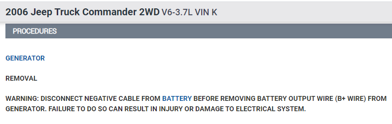

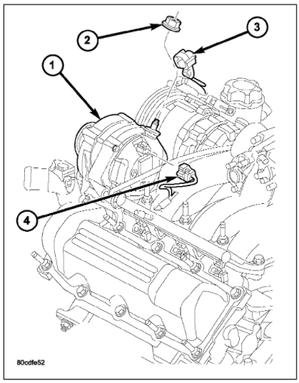

Usually, alternators just generally fail after time and mileage not by a sensor fault. Here is a tutorial showing you how to test and replace an alternator. Most local auto parts will test an alternator after removal for free.
https://www.2carpros.com/articles/how-to-replace-an-alternator

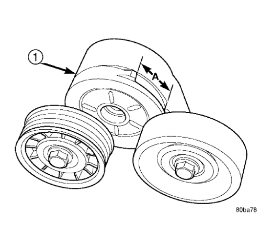

You will need to remove the serpentine belt from the engine first to remove the alternator. Here is a tutorial showing how to remove the serpentine belt:
I've attached picture steps below showing how to remove and replace an alternator and the serpentine belt on your vehicle. Hope this helps and thanks for using 2CarPros.
