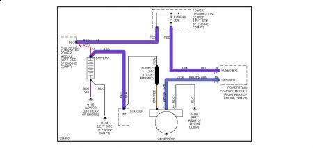

my alternator keeps dying we have replaced it three times and they battery light still comes on the end to the alternator was replaced but it still messes up has anyone ever had this problem before and if so how did you fix it thanks

Check fuse no.20 20amp if okay inspect wiring if it continues have the computer control of the field generation circuit checked out
https://images.2carpros.com/forum/automotive_pictures/12900_jeep_alty_1.jpg
