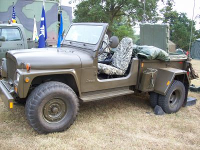

Roger, ...........Get your "TANK" a little higher than the pump (just to sorta aid in travel) You need more run time.......A plastic squirt bottle of gas, with a FINE STREAM....will let you feed it from a short distance.......Careful Flammable! I forget your Bowl is empty...no prolonged running! If still, we get nothing pumping.....funnel a liittle down the line.....to maybe "Prime the Pump" (this shouldn't need to happen) Next with the pump off, using a mirror and flashlight, and a "CRANKER HELPER".........while CRANKING.....observe the Eccentric Lobe (on the cam), that drives the pump.........Does it "WOBBLE" UP and DOWN? (pumping the pump arm if it were installed) I just got in from a Military Vehicle/ Airplane fly-in Your turn The Medic Check this out, just saw it while ago! A 1985 "258"Diesel CJ-10
https://images.2carpros.com/forum/automotive_pictures/411289_TRIPLE_TREE_FLYIN_003_1.jpg
