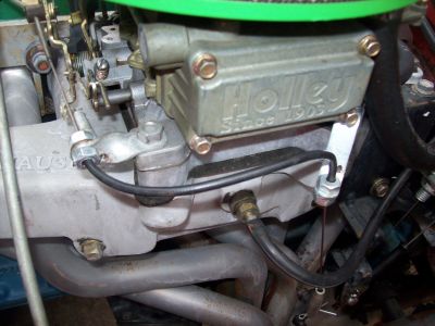

Roger, I check this real often. If you abide by the ONLY vacuum lines needed, and insure they are NEW or at least in "Servicable Condition", you will eliminate a bunch of headache. (then once you are satisfied with it, the "Dead Stuff" can be removed) How long ago was your carb rebuilt? By Whom? Reputation? Check your carb for loose screws in the body (some of which can only be accessed by removing the carb. Page 2 of the 1985 stalls when hot, explains carb adjusting. Try it also, get you a meter! Does your carb have the stepper motor on its rear? (wires into it?) Is your fuel filter still a 3 connection? (3 lines--1 in 2 out) When I was Jeep Stupid (1st Jeep) I had my carb rebuilt by a PRO???? It would not stay running without patting the gas when stopped, Another feller found 1st guy had installed the "Pivot Retainer" on the floats--in another WRONG POSITION. My floats were not pivoting--they were allowing the Needle and seat to be pushed open anytime they wanted. If you are going to possibly do another BBD carb---let me help with a recommendation (the least inexpensive way, EZ to adjust) I am going to send you a PM (private message) look for it. The Medic There is nothing wrong with a BBD---Some years seemed to have "Better Ones". I have a Holley 390 w/ vacuum secondaries on mine now, its a bit more expensive, and intake must also be changed...I finally got it figured out...but along the way, I sometimes wished I still had the BBD.
https://images.2carpros.com/forum/automotive_pictures/411289_100_0328_1.jpg
https://images.2carpros.com/forum/automotive_pictures/411289_regular_4_bbl_bicycle_cable_linkage_1.jpg
