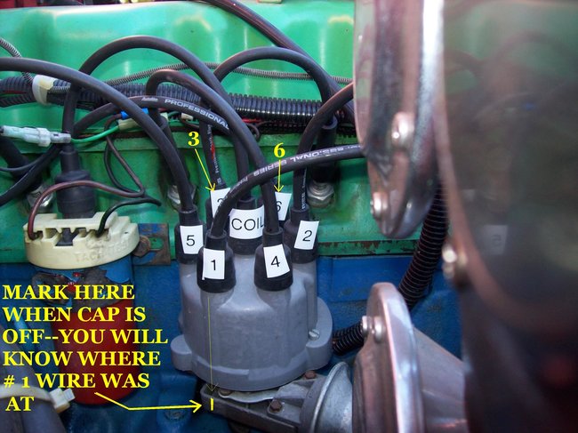

SEND REALLY GOOD PICS OF YOUR DISTRIBUTOR/ BOTH SIDES OF THE ENGINE AND A GOOD TOP VIEW (HOOD LAID ON THE WINDSHIELD FRAME)

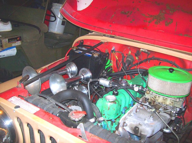

MY DISTRIBUTOR IS A MOTORCRAFT WHICH WAS INTRODUCED IN 1979 (MY JEEP CJ-5 IS A '77, I UPGRADED FROM A CRAPPY PRESTOLITE TO THE BETTER MOTORCRAFT)
PICTURE OF THE MOTORCRAFT BELOW (DON'T FRET, YOUR PLUG WIRE SEQUENCE MAY START AT A DIFFERENT TOWER, SO DON'T START MOVING THEM!- MY DISTRIBUTOR IS DROPPED IN "TEXTBOOK")

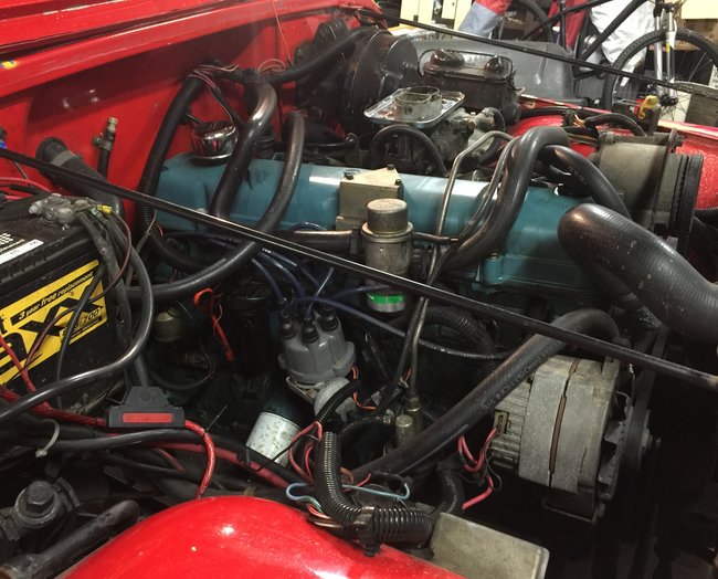

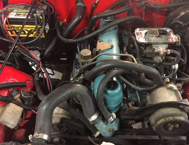

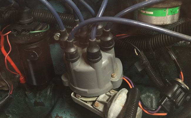

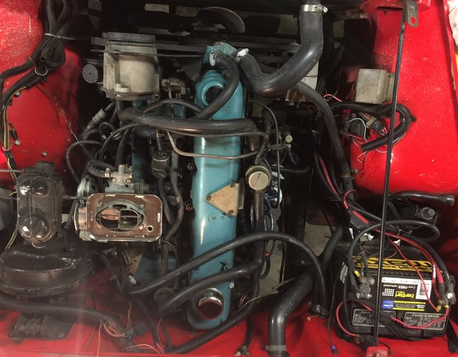

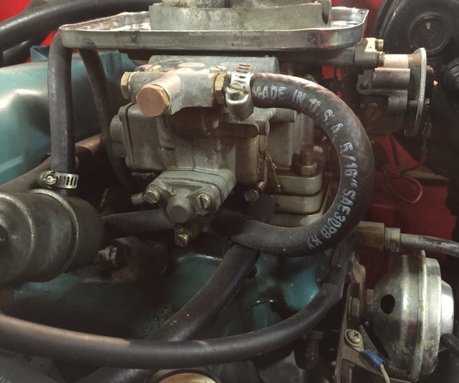

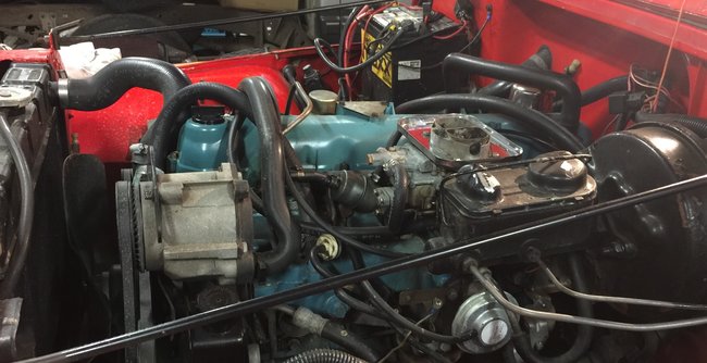

Here are a few pics of the engine bay, distributor and carb. If you need a few more let me know.

Sorry, here's the pics.

SEND PICS OF L & R SIDES OF ENGINE (FULL FRONT OF ENGINE TO THE REAR)
NOTICED YOU HAVE A WEBER CARB (AFTERMARKET)
I'VE HAD ISSUES WITH DIFFERENT BRANDS OF IGNITION MODULE - TO ME, ANY "GOOD" ONE IS ACCEPTABLE. FROM PAST EXPERIENCES OF TEARING MY HAIR OUT AFTER REPLACING A BAD MODULE WITH A "NEW" BAD MODULE LOOKING/ TEARING THRU MY WIRES FOR THE "NO START" PROBLEM FOR DAYS, THEN REALIZING IT WAS THE "NEW ONE"
I ALWAYS HAVE 'EM TEST THE NEW ONE ***** AT LEAST 5- 8 TIMES*****BEFORE I LEAVE THE STORE!
LET'S NOT BUY NUTHIN' AT ALL TILL I SHOW YOU A BUYING TRICK NEXT RESPONSE
SOLENOID AIN'T NO BIG DEAL- STORE BRANDS ARE FINE, YES, THE CORRECT ONE IS THE SAME AS FOR A '70s-EARLY '80s FORD
SOUNDING LIKE YOU HAVE A CARB OR VACUUM PROBLEM
BE ON THE LOOKOUT FOR A LOOSE/ DISCONNECTED/ SPLIT/ CRACKED/ COMPLETELY LOOSE VACUUM LINE OR FITTING. SEE IF THE CARB ANCHOR BOLTS ARE LOOSE.
WE'LL GET YOU TUNED UP TOO, AFTER WE GET THE HEARTBEAT BACK

I did check to see if any vacuum lines were disconnected and didn't find any. I will have to check this afternoon to see if any are loose, split or cracked. I'll also check the carb anchor bolts.
I'm in a little town by the name of Cope SC. It's in between Bamberg and Orangeburg.
If these pics still do not let you see everything you need, let me know what part you do need to see and I'll snap a pic of it. For some reason my cell will not let me resize a photo without cutting most of it off.

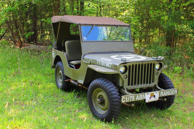

HOMEBOY!
STATIONED IN SAVANNAH, HUNTER ARMY AIRFIELD DURING THE '80s (AIRBORNE RANGER)
JUMPED ONTO AND FLEW FLEW INTO NORTH FIELD MANY TIMES (ACCIDENTALLY LEFT THERE IN THE WOODS ONE NIGHT W/ ANOTHER FELLER WHEN THE SGT IN CHARGE OF THE PLANE'S PASSENGERS HAD A BRAIN FART. HE GOT CHEWED GOOD WHEN WE WERE UNACCOUNTED FOR!
WHEN I WAS A KID MY DAD WAS LOOKING FOR LOST RELATIVES IN CEMETERIES AS A HOBBY, WE WENT DOWN YOUR WAY TO A "SOMETHING" SWAMP CHURCH GRAVEYARD. THE CHURCH WAS ACROSS THE STREET AND HAD A DOME ON TOP. YOUR TOWN WAS CLOSE AND HAD OLD HOUSES AND BUILDINGS SITUATED AROUND THE RAILROAD. (ALSO SEEN WHEN I WAS IN THE ARMY)
I HAD PROBLEMS POSTING LAST TIME, I LOST IT ALL TWICE, I DID MENTION IN THOSE THAT THE CAR IS NICE (EVEN THOUGH I LIKE JEEPS MORE BETTER!) AND THE JEEP IS NICER!
I'M ABOUT 100 MILES NORTH WEST OF YOU
I'M GONNA PUT YOUR PICS IN "MY PICS" SO I CAN BLOW 'EM UP BIGGER TO LOOK 'EM OVER

MY 1ST AND 2ND JEEPS BELOW

I checked for cracks, loose and tears on the vacuum lines but did not find any. I also checked the bolts in the base of the carb but they were tight.

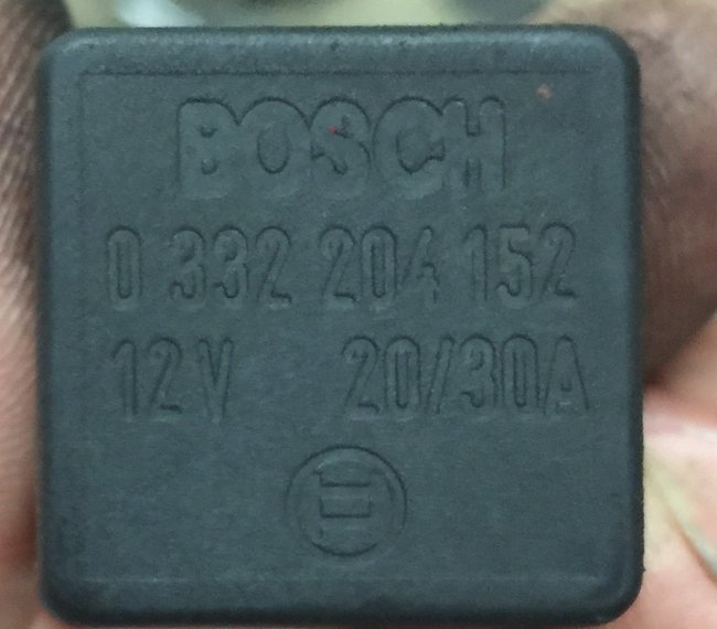

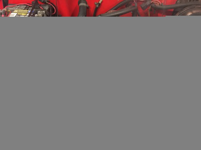

Take a look at the pic below and let me know if you think this fuse can be tested and what it may be for. It's plugged in the harness that lays against the firewall right behind the carb.

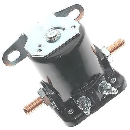

BATTERY CABLES
POSITIVE TO THE SOLENOID
*****NEGATIVE TO ENGINE (SIDE OF BLOCK OR HEAD)*****!
ANY OTHER WAY MIGHT SET A WIRE HARNESS ON FIRE! AS THE STARTER WILL FIND A GROUND IF THE "BIG ONE" IS OUT OF ORDER AND DOESN'T CARE WHAT SIZE THE WIRE IS. WITH THE BATTERY CABLE GROUNDED ON THE ENGINE, THAT IS THE MOST DIRECT ROUTE TO THE STARTER.
USUALLY THE DRIVER'S SIDE HAS A CABLE OR WOVEN STRAP JUMPING OVER THE MOTOR MOUNT (THIS WOULD GROUND THE BLOCK TO THE FRAME)
NORMALLY A WIRE JUMPS FROM NEGATIVE BATTERY TO THE BODY (FROM THE BATTERY CLAMP OR THE CABLE TO THE BODY)
THE "BOSCH" THINGEE LOOKS LIKE RELAY- DOES IT HAVE 4 OR SO PRONGS ON THE BACK? IT MAY BE FOR FOG LIGHTS/ ELECTRIC FUEL PUMP ETC.
DO YOU HAVE A MECHANICAL (STOCK) FUEL PUMP OR A ADD ON ELECTRICAL?
BELOW IS A "STOCK" CJ SOLENOID
