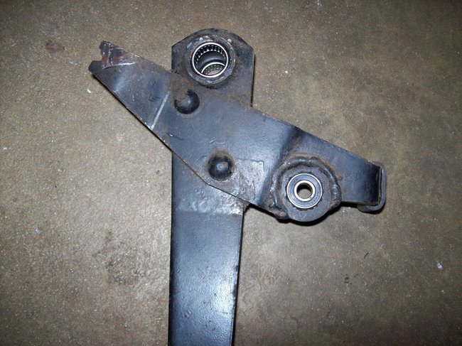

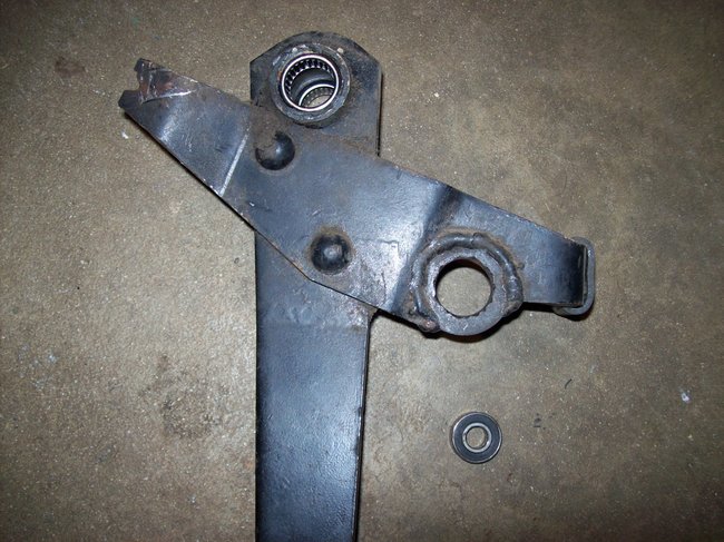

Pic 1 and 2) 2 "doughnuts" are cut out using 1/4" flat steel. I used a drill press and 2 hole saws. I used the pilot bit and cut both holes maybe 7/8 through. I then took off the pilot and cut the smaller hole all the way out. Then did the same for the outer hole saw (oiling all the way to cool it was a must!)
I measured the old hole's center off of the bell crank's body and centered my 1st doughnut on that hole. I then marked the "old flat steel" on the bell crank. Then I sawed off the old hole and welded my doughnut onto the "old flat" of the bell crank.
End result- Big hole in the same exact spot as the the smaller original.
Insert roller bearing, the clutch rod, a big washer on either side. Top it off with a cotter pin. Pic 1) bearing in place, Pic 2) washers in place.

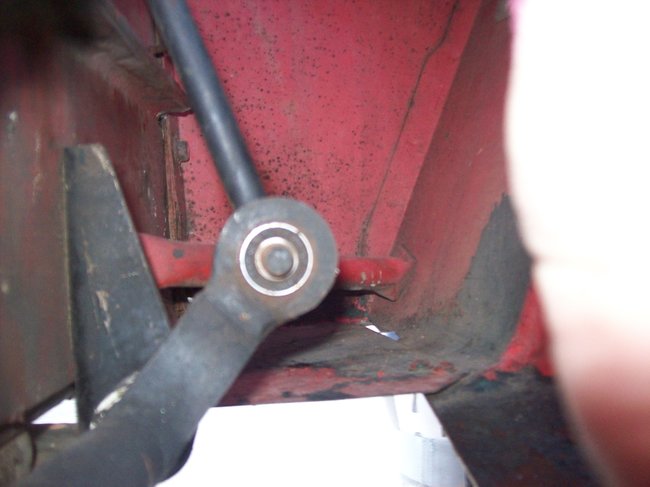

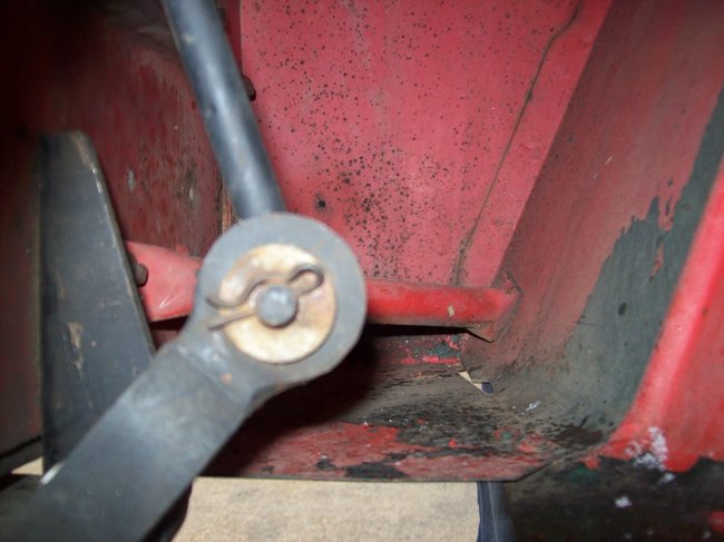

Pic 2 and 3 and 4) Remove clutch pedal (fun!). With a slightly larger hole saw than the doughnut chuck it up and vise down the pedal tight in the vise. I think I did not use a pilot bit and slowly lowered the hole saw into the pedal's hole insuring it stayed centered. (pic 4 is "in place")
When finished, I installed doughnut number 2, insuring it was "square" or "perpendicular" in the new (over the old) hole before I welded it in place.
End result- Big hole centered perfectly where the old one was.
Install bearing, Clutch rod then a washer on either side and a cotter pin.

I'm going to look for the part numbers and descriptions of the bearings and the dimensions of them so you can select the hole saw sizes. The sizes were snug when all was done (no floppy holes). This did take some thinking and testing (hole sawing) before I started actually chopping on stuff.
My modification is still in place after being installed in 2010, It works just as smooth as "Day 1", It has no wear!
