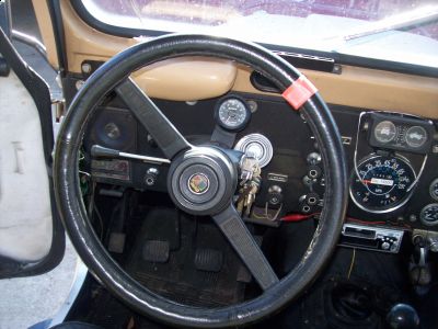

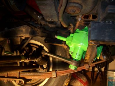

Sorry took so long, was cropping and down-sizing my '46 WILLYS into a Avatar. Not an expert on alignment, nor mechanic, or paid at this site. Got here like you. Owned nothing but CJ5s and 1 Willys since I started driving in 1981........Have been my own mechanic for most of this time. I am very knowlegable on most problems, have rebuilt 3 of my own from GRD - UP......helped on many more. Your lift may affect Caster. Toe in----Toe out .....refers to frt of wheels being closer or further apart Camber.....is the top of your tires leaning INWARD or OUTWARD (viewed from frt. a "V" or a NEG. "V".........Camber to my understanding, coupled w/ caster helps keep you straight CASTER is these above elements, coupled with ROTATING the whole AXLE rearward (using the welded on spring mounts[factory] or using Wedge-like shims between the springs and their mounts.... to "manually[EZ]" rotate axle, without grinding off and re-welding the spring mounts) .....CASTER is BASICALLY making your wheels track like a SHOPPING CART. Helps Jeep steer itself. I just changed my steer gear for excessive play, it would stay straight if I held slight pressure L or R (did not wander by itself, up to 60 mph) if measured from 12 o'clock around wheel I had 5 inches of play (L or R depending on "HUMP in center of road, which side I was on)......now have 3/4 inches of play, found OEM Saginaw steering gear on Ebay for $179 could not pass it up ......Whats your thoughts?.....Love, Turddog (slow typer) ORIGINAL PLAYLIKE A FULL 1/8 OF A TURN ! ! !
https://images.2carpros.com/forum/automotive_pictures/411289_straight_in_right_lane12_oclock_1.jpg
https://images.2carpros.com/forum/automotive_pictures/411289_straight_in_left_lanePLAY_from_12_oclock_1.jpg
NEW GEAR, ZEROED (CENTERED), INSTALLED (little play now)

Note homemade steering gear Brace (saved about $60) attached to FRONT Towing Reciever [closest to you] TO anchor bolt on gear (angle iron covering green), RT side of output on gear, FRAME does not TORQUE or twist while steering (this was additional lost motion, or play)
