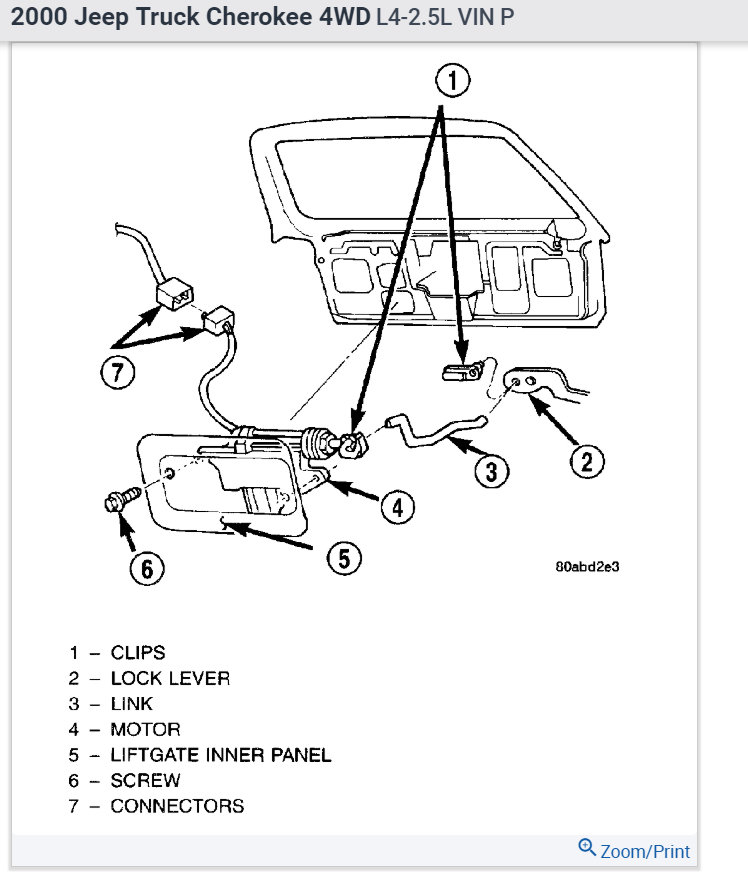

I have a Grand Cherokee Laredo with power locks. When you try to use the switch it makes a loud buzzing or screeching noise. The rear passenger door does not unlock at all. The hatch is stuck on lock. Cannot get into the hatch or the hatch window at all. There is no key entry for the hatch either. So I am locked out of the hatch forever more. Purchased a master control switch (actuator?) for the drivers door. That only took care of the problem with the driver door lock. What do I do next?

I had this problem as well I found which the door lock on the passenger's side was making noise and replaced it all fixed! Cost me $43.00 for the lock actuator. Here is the guide I used below.

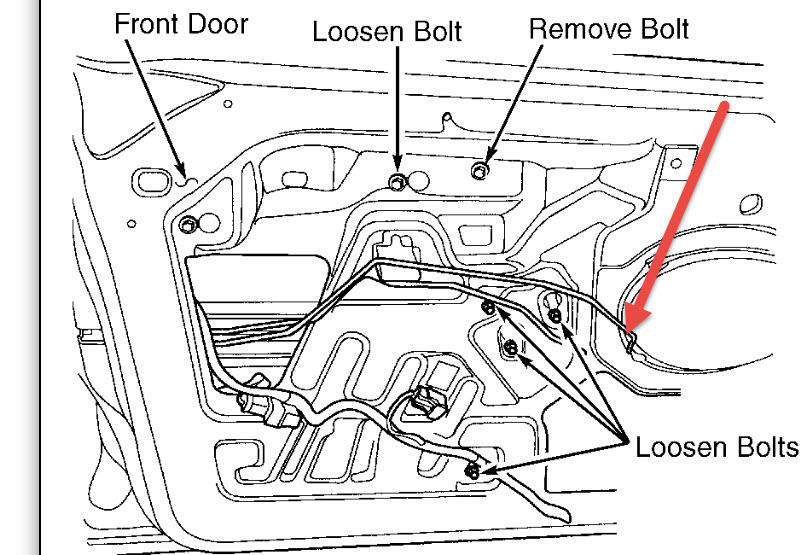

Check to see if the door lock actuating rod has a broken clip. These are cheap plastic or metal and they break the rod falls out of position. Arrow in picture shows where to look for the clips on both ends. Also, check to see if wiring harness is hitting one of the door clips it may or be pinched. It might ground out.

AJPENNELL
First I want to thank you for your help. I have looked at the drawing but let me give a little more information. I am convinced that the issue is mechanical. When I have the door panel off and the lock cable linkages disconnected. The lock/unlock works correctly whether by key, push/pulling the cables or the power lock button. It is when I put everything back together that the problem happens. The mechanical lock/unlock button gets jammed in the forward (lock) position and cannot be put in unlock, although the door is unlocked. Also though the key can be turned it does not lock the door and it resists turning. My thoughts are either the cables got bent, the door brackets are malfunctioning, or something is out of line at the lock mechanism itself which I reached and felt but cannot feel anything wrong.
The clip shown in the drawing seems to be okay although maybe it has a break in it that malfunctions when everything is together. I will look at that. Otherwise, something apparently gets out of line. Any ideas what might happen at the lock mechanism as I really cannot see that very well? I have attached some pictures but doubt they help.
