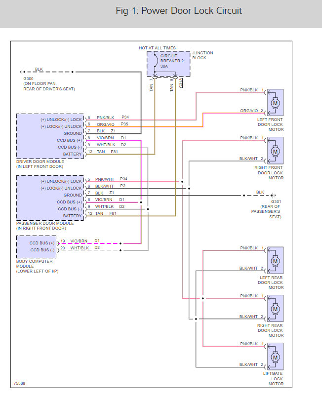

My power locks wont work. I can hear the relay switch clicking but there is nothing happening with the locks. How do I fix?
Tuesday, September 7th, 2010 AT 6:33 PM
13 Replies
  • 110,047 POSTS
It sounds like you have a drivers door module that has gone out but to be sure lets run down the wiring to make sure we are all good. Here is a guide and the door lock wiring diagrams to help us get started. I also included the DDM location in the driver door as well.
Check out the diagrams (Below). Please let us know what you find. We are interested to see what it is.

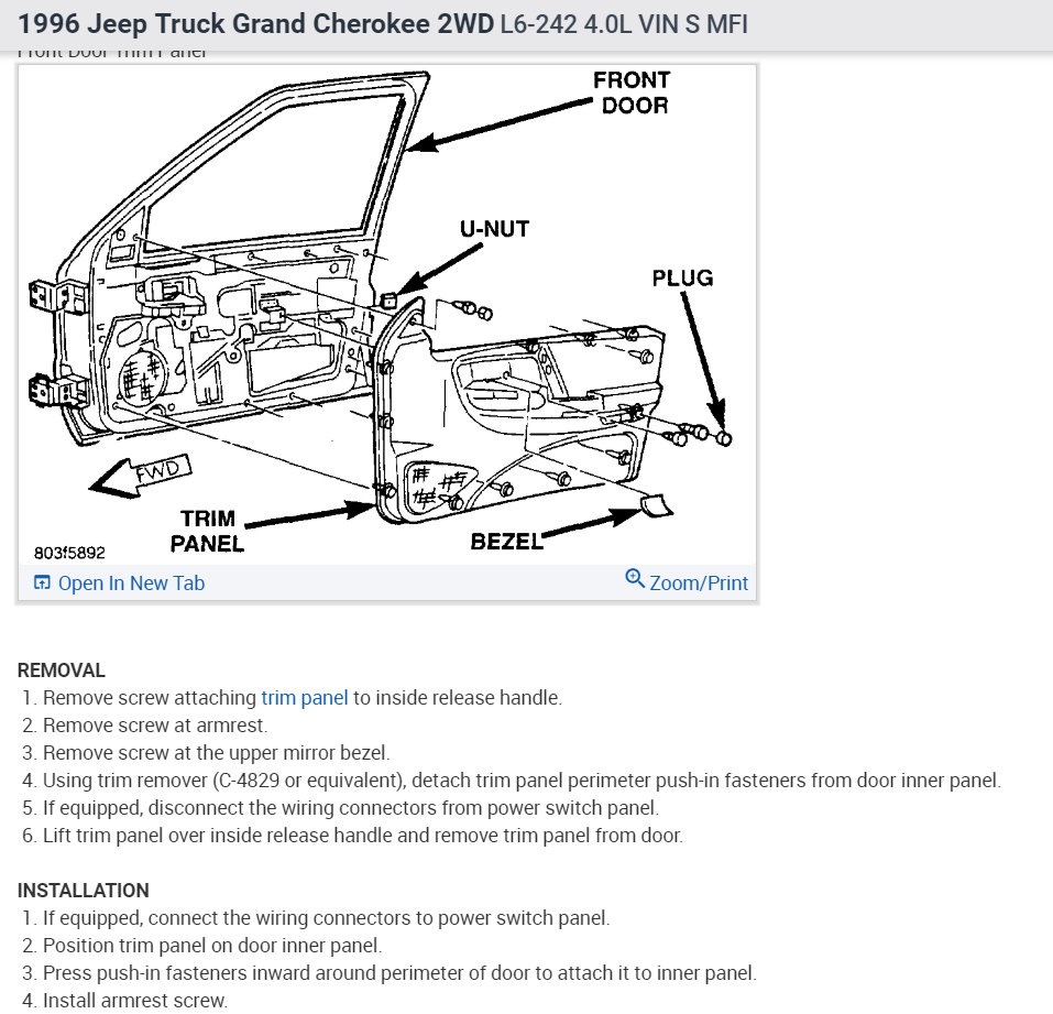

You need to remove the driver's door panel and check for power to the main switch.
+1
Thursday, September 9th, 2010 AT 8:08 AM
GRATEFUL DEAD
I took the driver side door panel off and saw that everything was connected. No wires were loose or broken. I also took the passenger door panel off and found the same thing. Locks still wont work

Under the hood is a power distribution box. Check for a door lock relay and switch it with another relay with the same part number to see if that helps.
Friday, September 10th, 2010 AT 10:25 AM
GRATEFUL DEAD
I checked out the DDM and everything works thanks for the help I should have done that first DOH. Cost me $135.00

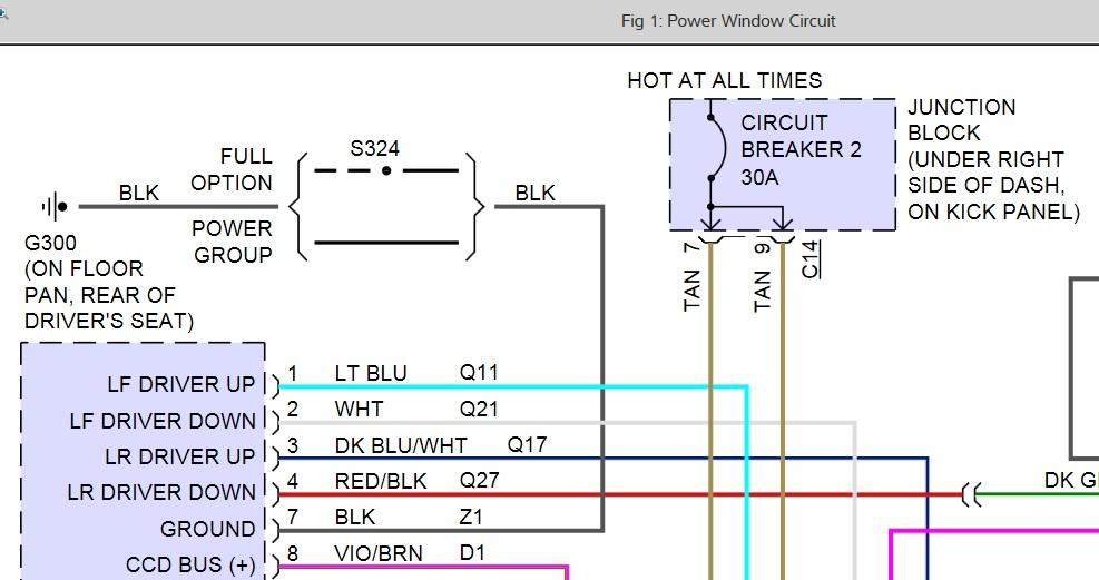

I have a 96 Jeep Grand Cherokee which all of a sudden all power door locks, windows and outside mirrors no longer work. I have checked the fuses under the hood (power distribution panel) all check out okay. Checked the fuese inside the right side kick panel, all but one fuse checks out okay. I've replaced the one fuse that looks okay, but still get no power to or thru it. What else/where else should I look? I suspect it is some type of fuse or central power device that needs replacing.
-1
Tuesday, January 29th, 2019 AT 1:05 PM (Merged)
JDL
  • 16,098 POSTS
Sorry for the late reply.
There is a circuit breaker for power windows, check for voltage at circuit, hot all the time. By fixing one system it may or may not fix the others.
Also check the wire harness going into the driver door, hinge side. It probably has a rubber boot protective covering, pull the boot back to access proper wire color to check. Because you open/close that door so much, sometimes the wires break. As you can see in diagram, the tan wire is voltage to driver door switch, black wire is ground.
