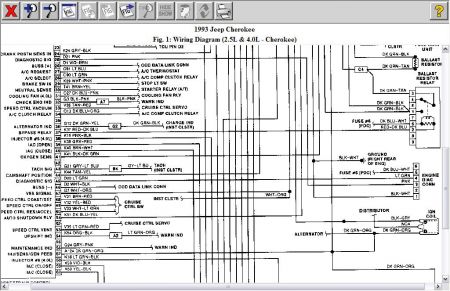

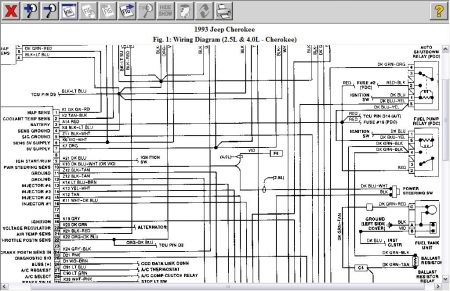

Check fuse #2 at power distribution center. At PCM pin out no.3 put key to On.=-do u have power At PCM pin out 51 crank engine over while looking for power there-no power ASD relay defective. Hope this will help you tried to bring it up closer but couldn't do it. No PC experience on magic stuffs and so on. Sorry maybe someone in here can jump in and give a better picture. Good Luck
https://images.2carpros.com/forum/automotive_pictures/12900_1993_PCM1_1.jpg
https://images.2carpros.com/forum/automotive_pictures/12900_1993_PCM2_1.jpg

JEEPIN'
[quote:5d39d018c6="rasmataz"]Check fuse #2 at power distribution center.
[/quote:5d39d018c6]
Fuze 2 is good. the pins aren't labled so I counted left to right and down, is this correct?
pin 3 has 12v before and after the heep stalls, 51 has 12v before and after it stalls but only 10v while cranking
