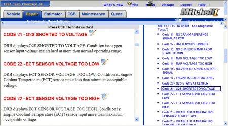

I have an ongoing propblem wit an error code 21 for my 94 jeep cherokee country. I have replaced the o2 sensor 3 times replaced relays cleaned contacts and it still perisits. Does anyone have a clue as to what to do or look for. I'm stumped.
Sep 20, 2008 at 3:42 AM
  • 75,992 POSTS

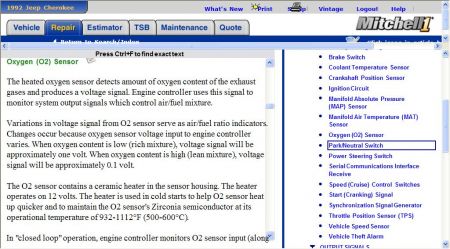

Are you using OEM parts? 02S shorted to voltage check the wiring all the way back to the computer

Check the voltage to it-I don't have the resistances specs-the voltage should be .45volts if its switching properly from lean to rich and vice versus-

You look for what's causing it to go lean such as below
A lean fuel condition can be caused by:
* Low fuel pressure due to a weak pump or leaky fuel pressure regulator. (use a fuel pressure gauge to check fuel pressure at idle)
* Dirty fuel injectors. (try cleaning the injectors)
* Vacuum leaks at the intake manifold, vacuum hose connections or throttle body. (Use a vacuum gauge to check for low intake vacuum)
* Leaky EGR valve. (Check operation of EGR valve)
* Leaky PCV Valve or hose. (Check valve and hose connections)
* Dirty or defective Mass Airflow Sensor (MAF). (Try cleaning the MAF sensor wires or filament with aerosol electronics cleaner. Do NOT use anything else to clean the sensor, and do not touch the sensor wires)
