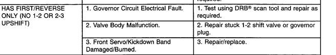

2CARPRO JACK
  • 11,533 POSTS
Those are both governer pressure codes, not real sure if it will be a DIY project to fix.Will require some diagnostic with a meter and scanner to fix, the only possibility in the list that looks easy, is to try a trans service it could set codes due to excessive debris in th etrans pan. Try a service first

MHPAUTOS
  • 31,937 POSTS
Do you have reverse? if so check chary below.

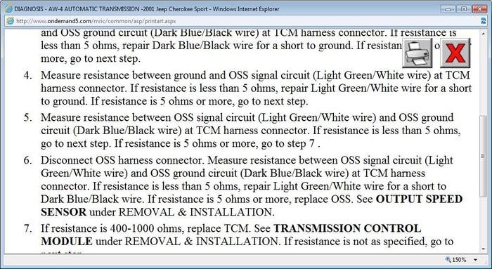

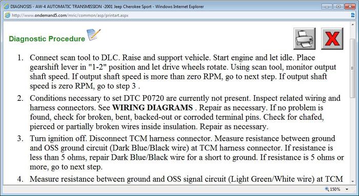

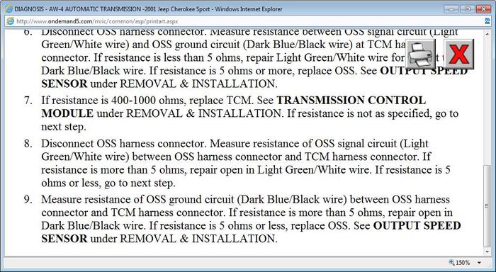

SATURNTECH9
  • 30,869 POSTS
Have you checked the transmission line pressure yet with a pressure gauge?I always do that before replacing anything.Also have tried to diagnose the P0720 yet?
Jul 27, 2020 at 5:12 AM (Merged)
DESERTJEEPER
  • 6 POSTS
Have not checked line pressure yet. The P0720 code may be coming from the wiring itself. Its been awhile since I checked but I think it was over the 5 ohms for any part of that circuit stated in the powertrain and diagnostics manual from jeep. The sensor, when checked with a multimeter, puts out a beep every time the rotor passes by it (am I correct in thinking its an induction type?). When I get some time, I plan to repair that wiring harness.
SATURNTECH9
  • 30,869 POSTS
Which model cherokee do you have classic sport etc?Also what size engine do you have?
DESERTJEEPER
  • 6 POSTS
2001 Jeep Cherokee 60th Anniversary Edition. VIN puts it down as Sport. Engine is 4.0L 6 cyl 242 naturally aspirated.
SATURNTECH9
  • 30,869 POSTS
I posted the trouble tree for code P0720 lets follow that trouboe tree and see what you find.I have seen output speed sensor issue cause transmission issues.
