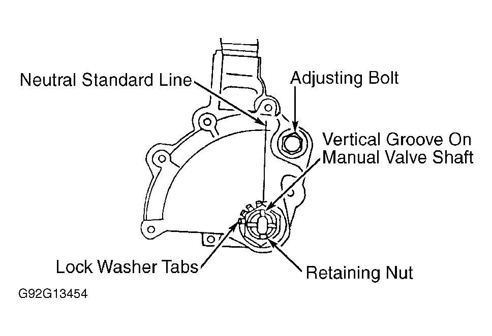

I removed the adjuster bolt and then the other bolt holding it in place. It wiggles around a lot but won't slide off. I've sprayed it with wd and it still does nothing. Im afraid to pry on it because with my luck i'd end up bending something vital plus there isn't much room to pry because of the exhaust. Any help?

Remove adjusting bolt, nut and lock washer then "O" ring will hold take two small screwdrivers place between trans body and switch @180 deg apart rock drivers it will pop

Diagram

The problem I am having is I'm trying to install a neutral safety swith on my jeep and its not going on.
We got the old one off after hours of tinkering and compared the new with the old and they were the same.
We connected the new one without mounting it with the nut turned to the neutral position and tried starting it but it would not start. I don't know if it has to be mounted to start or will it start with just the electrical being connected?
Also the new one will not slide onto the shaft I tried sanding off all the rust and then sliding it on but it wouldn't go. How easily should they go on? Is it possible that we bent it?
Previous to all of this I brought it to a garage and they told me it was the neutral safety switch. So im assuming it is the switch but if it doesn't start after its installed what should I look at next?
Thanks

As the trans linkage turn on the trans, it moves the switch. You have to locate the position of park and/or neutral when not mounted to see if it will start.
As far as the mounting, is the switch identical to the old one? If so, then it is a matter of lining it up correctly.
Can you take a picture and post it?

How do you get the neutral safety switch of the AW4 transmission? The chrysler manual says it lifts off after removing the adjuster bolt and attaching nut but this one will not. I've even tried prying on it to get it to come off. Any Ideas?

It's probably been on there since 1991 so I bet it's just stuck. Are you replacing it? If so, pry harder! It'll come off if the nut's been removed. Try spraying some PB Blaster or other penetrant to break it lose.

I tried liquid wrench on it and there isn't enough room to pry very hard on it. There are metal trans. Lines going across it as well as the exhaust pipe to contend with. There is a threaded piece around the manual shift shaft that seems to be holding it in. This is the piece that the nut threads onto. I was thinking that maybe that need to be broken off in order to get the switch off. It looks like it's part of the switch, that's why I thought it needs to go.

If my memory serves me correctly, is should just come straight out. You may have to pry the lines away from it some but it can be done. If it simply won't come loose, you may have to take more drastic measures, like removing the exhaust, or removing the trans. Crossmember and lowering the rear of the trans to allow better access. Keep trying and good luck
