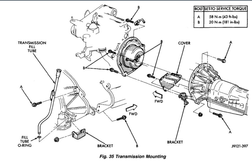

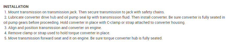

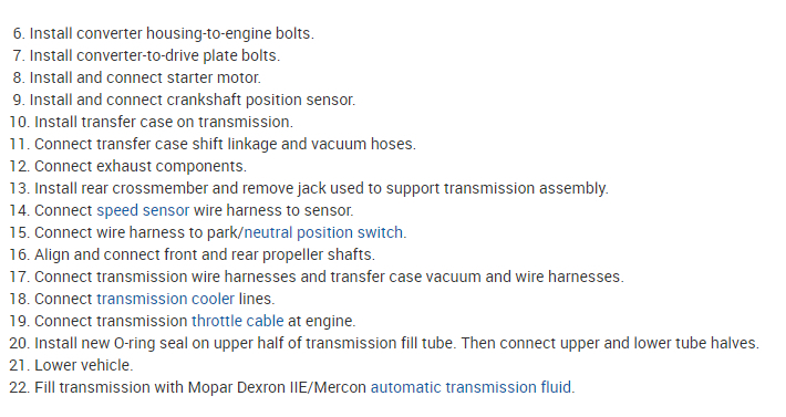

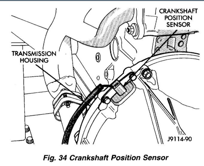

I need to know if I can replace the transmission?
Feb 26, 2017 at 6:25 PM
DANNY L
  • 5,648 POSTS
Hello, I'm Danny.

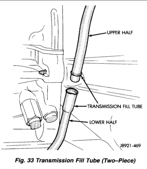

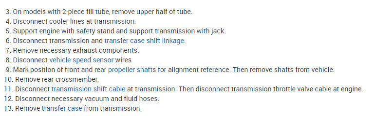

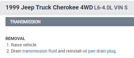

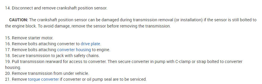

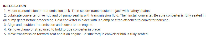

Here is the transmission replacement information you requested. Here is a manual transmission tutorial for you to view. Removing an automatic transmission is similar:
https://www.2carpros.com/articles/transmission-replacement-removal-manual
I've attached picture steps below showing how to remove and replace the automatic transmission in your vehicle. Hope this helps and thanks for using 2CarPros.
