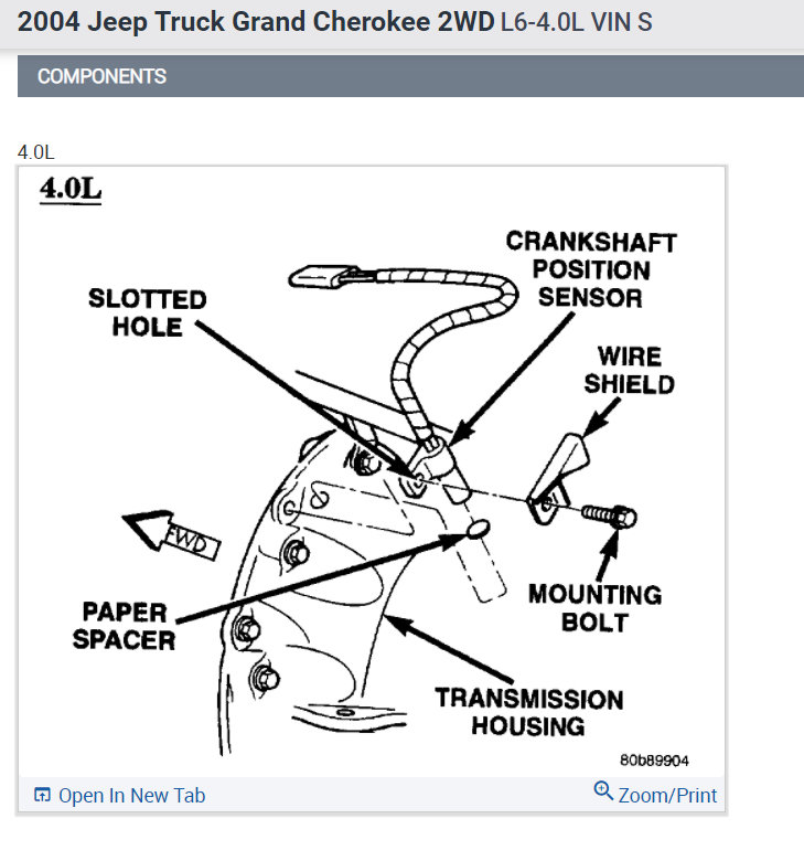

while driving the engine stalls , and sputers and jerks , the problem is very intermittent, Before the engine stalled there was a check engine light on with a code which was driven for about a year wirh no problems, it had a couple codes of which one was the fuel cap which was replaced with no aid to the light, Recently while on the highway going about 60 mph the engine stalled, I noticed the first time the speedometer went from 60 mph to 40 mph in about a second plus the RPM gauge went down quickly as well, Thre last time it stalled there was a little more than one half of tank of gas the fuel gauge went to empty during the stall and few seconds later the fuel indicated correctly, So far I changed the fuel filter and the spark plugs and cleaned the throttle body
Mar 23, 2009 at 6:44 AM
DKAVANAY
this sounds like he same thing that happened to my car i had to replace the crankshaft angle sensor here is show in the diagrams below also this guide can help others
https://www.2carpros.com/articles/engine-stalls
Apr 20, 2009 at 4:47 AM
DEMCULLUM
Well almost $1,000 later I traded in the Jeep while still having intermittment problems. Luckily for me the problem did not occur when I traded it in. After a local good mechanic did not fix my problem I did bring to the "dreaded delaer" I was first told it was the computer hte PCM that was bad, so I had them to change it. Parts and labor of $420. Then before fixing the problem they did tell me that they need to fix the computer before finding out if there is any ohter problem. Once they changed the PCM they then told it was the fuel pump. Which they wanted another $500 for. So I had my mechanic change the fuel for aprox $300 total. After the fuel pump was changed then I had a new code for Camsahft sensor which
I changed myslef form Autozone for $30. To make a long story short the Jeep still has a mind of its own. My mecanic seems to think the dealer never changed the brains. I think there a an intermittent short circuit. The reason I think that is when the battery is reconncted is the cable sparks alot indicating to me short. Good luck.
Apr 20, 2009 at 5:49 AM
LYNNBEN
Did they even try the crankshaft sensor it fixed my car never stalled again.

My 2004 Jeep Grand Cherokee 6 cyl has a weird problem my techs can't diagnose. While driving on a daily basis the tachometer and speedometer will dip down occasionally when I hit a pothole or bumpy road. No other gauges are effected. After a while the engine will stall when this happens, usually causing loss of power to the engine, and eventual shutoff of the engine. The check engine light never lights up, and when scanned for codes none exist and none are pending. As a matter of fact when this condition occurs the entire computer is reset to 0 engine starts since last scan. The tests are also showing not ready and no drive cycles completed. The wiring harnesses and connectors visually look OK as far as we can tell, and when testing the 5V and grounds at the terminals while parked things look good at inspection. We suspect somewhere somehow some component is shorting out the 5V but no idea where to start. Or we could be completely off and need your expertise.......
Oct 16, 2020 at 5:15 AM (Merged)
SERVICE WRITER
  • 9,123 POSTS
Look for the engine harness damage at the left rear head stud I have seen several rubbed thru and cause this condition ...it is usually poked thru the harness tubing.
Also, check the ground on right side of the block. Remove, clean and reinstall.
PCRAIN60544
Thank you, will have those items inspected today and report back with the findings.
PCRAIN60544
Harness did show signs of wear through tubing, but no sign of wire insulation failing. Did rewrap and protect just in case.
Also replaced the crank sensor as proactive step since they fail so often and it was only 30 dollars.
Really won't know until road tested for a few days
But thanks for the good advice

Change the Crank Sensor. This should solve this problem. I had the same exact problem with my Jeep Grand Cherokee Laredo. I talked to several area mechanics and they all agreed to change the crank sensor so that's what I did. So far so good been 3 months now with no stalling.
