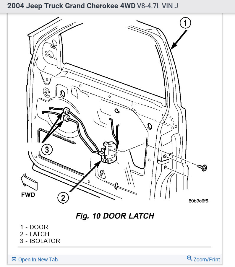

RYAN MILLER2
Had this problem early Sunday Morning. My interior lights would not go off when exiting the vehicle and locking the door. the strange thing is if I go in from the passenger side and put my key in ( I just turn the accessories on and then take the key out) then close the passenger door and lock the door and then they go out.
Oct 15, 2018 at 12:42 AM
  • 55,224 POSTS
It sounds like you have a drivers door latch that is our. What happens is the micro switch inside the latch goes out. Here are diagrams to help you change it out:
LATCH
REMOVAL
1. Remove glass run channel.
2. Remove screws attaching door latch to door (Fig. 10).
3. Disconnect all rods from door latch.
4. Disconnect wire harness connector.
5. Separate door latch from door.
INSTALLATION
1. Position door latch at door.
2. Connect wire harness connector.
3. Connect all rods to door latch.
4. Install screws attaching door latch to door and tighten to 11 N.m (8 ft. lbs.). (Fig. 10)
5. Install glass run channel.
6. Adjust the latch.
