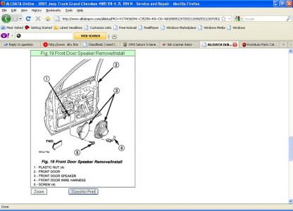

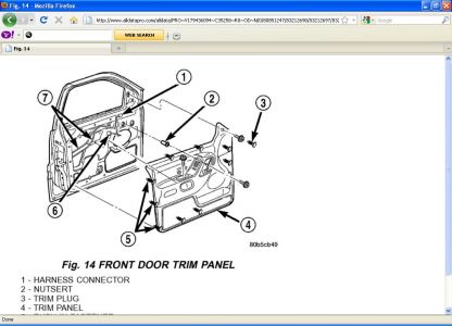

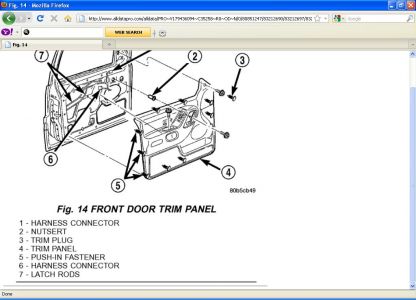

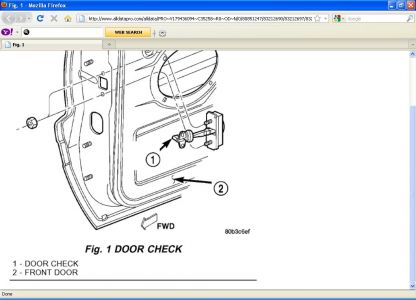

I have the grand cherokee limited, it is the front drivers door, I need to know how to get it out of the door and replace it, if I can find one from some one other than the dealer(way too much)

https://images.2carpros.com/forum/automotive_pictures/416332_2001_jeep_grand_cherokee_door_panel_part1_1.jpg
https://images.2carpros.com/forum/automotive_pictures/416332_2001_jeep_grand_cherokee_door_panel_part2_1.jpg
1. Remove trim plug from mirror flag bezel. Fig. 14 2. Remove three screws attaching trim panel to door (Fig. 14). 3. Using a trim stick C-4829 or equivalent, detach trim panel perimeter push-in fasteners from door inner panel. 4. Lift trim panel upward and separate from door. 5. Disconnect latch rods from inside handle actuator. 6. Disconnect harness connectors for power accessories. 7. Separate trim panel from vehicle. INSTALLATION 1. Connect harness connectors to power accessories. 2. Connect latch rods to inside handle actuator. 3. Position trim panel on door inner panel. 4. Press trim panel push-in fasteners inward around perimeter of door. 5. Install screws attaching trim panel to door (Fig. 14). 6. Install trim plug in mirror flag bezel.
https://images.2carpros.com/forum/automotive_pictures/416332_2001_jeep_grand_cherokee_door_check_link_1.jpg
1. Remove the waterdam. 2. Remove screws attaching door check to A-pillar. Fig. 1 3. Remove nuts attaching door check to door (Fig. 1). 4. Remove door check through speaker location hole. INSTALLATION 1. Position door check on door through speaker location hole (Fig. 1). 2. Install nuts attaching door check to door and tighten to 11 N.m (8 ft. lbs.) . 3. Install screws attaching door check to a-pillar and tighten to 15 N.m (11 ft. lbs.) . 4. Install the waterdam.
https://images.2carpros.com/forum/automotive_pictures/416332_2001_jeep_grand_cherokee_front_door_speaker_1.jpg
Front Door Speaker 1. Disconnect and isolate the battery negative cable. 2. Remove the trim panel from the front door. Fig.19 Front Door Speaker Remove/Install 3. Remove the four screws that secure the speaker to the front door inner panel. 4. Pull the speaker away from the front door inner door panel far enough to access the front door wire harness connector. 5. Disconnect the front door wire harness connector from the speaker connector receptacle. 6. Remove the speaker from the front door inner panel. There is how you change the check link.How much does the dealer want for your check link?
