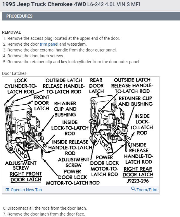

the driver door side door latch is fliped in so the door will not close or lock how can I fix this?????

ok, first take a screwdriver and push the door button or lever *what you use to open the door* while pushing the button or lever use the screwdriver to pull it up, if it wont come up push it down further then try to pull it up.

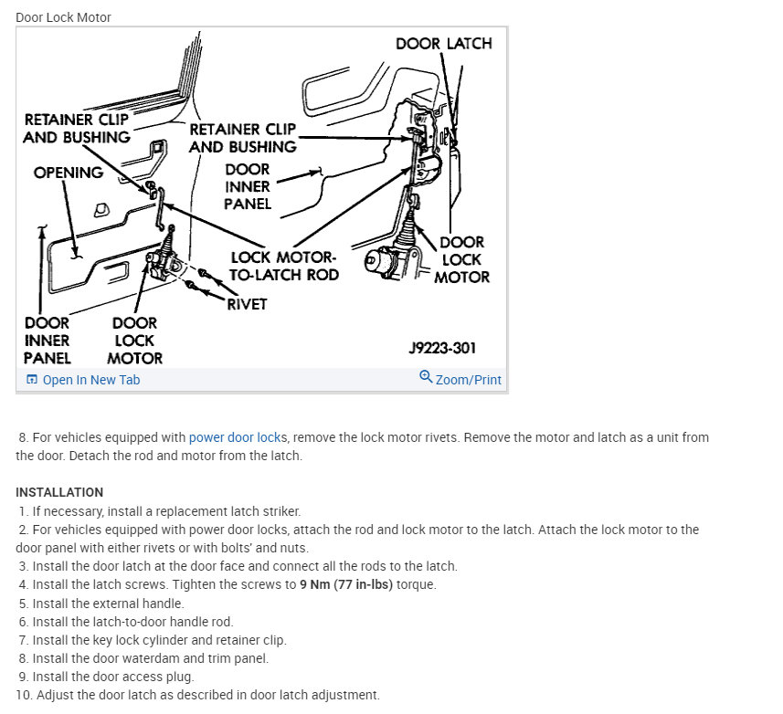

Hey RBellon,
It is always great so see someone finding a solution long after it was provided.
This trick will generally work on these older vehicles with that type of latch. These tend to get stuck and sometimes using some lubricants can help.
I have attached diagrams for anyone might be looking for little more info.
Let us know of any questions.
https://www.2carpros.com/articles/car-door-hood-or-trunk-will-not-close
