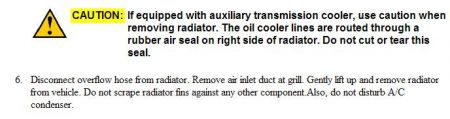

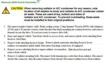

Ok, so I am in need of some step by step instructions on how to replace a radiator. I am confident it is something I can do without a trained professional but just need some guidance please help me

https://www.2carpros.com/forum/automotive_pictures/261618_Noname_847.jpg
https://www.2carpros.com/forum/automotive_pictures/261618_Noname2_222.jpg
https://www.2carpros.com/forum/automotive_pictures/261618_Noname3_79.jpg
