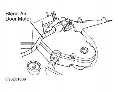

Ok the engine is made to run about 209, the aux fan isn't made to come on till 218 this is normal for Chrysler. My Jeep with the 4.0 runs at 205. The fluid going up and down with the cap off is normal. So with that I would put the cap back on and if the temp stays about 210 and don't go past 218 then you are ok, if it still worries you then go to a shop and have them use an infered thermeter and make sure all it ok. Now as for the heater that is another problem I would check the vacuum lines for the heater first. If all looks good then I would suspect the heater blend door or blend door motor. When you are ready we can check that it is over in the passanger side near the glove box area. To answer you last question 966 is last 3 of my birth year the avatar is from the Mustang club I am part of as a Mustang enthusiast. Here is a pic of the blend door motor.
https://www.2carpros.com/forum/automotive_pictures/249564_Graphic_179.jpg

I'm having the pressure checked in the coolant system around noon today. The two heater lines running along the valve cover to the heater core never get hot. The main big hose going into the radiator (on top) doesn't feel pressurized - no flow. Maybe that once the radiator/coolant system problem is fixed the heater will blow hot (blows cold now).
If I try the burping process again will the engine melt or get damaged even if the gauge doesn't go into the red zone? Does the gauge measure the coolant temp or the actual engine temp? If there is no coolant circulating through how do we know how hot the engine is?
