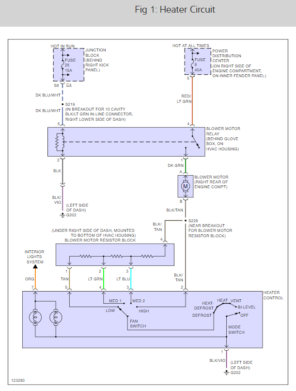

I can hear my air turning on and the heat when turned on but the blower will not run. I have replaced the blower resister and took out the blower and tested it and it runs. What could cause the blower not to get power?
Apr 17, 2019 at 6:31 PM (Merged)
WRENCHTECH
  • 20,761 POSTS

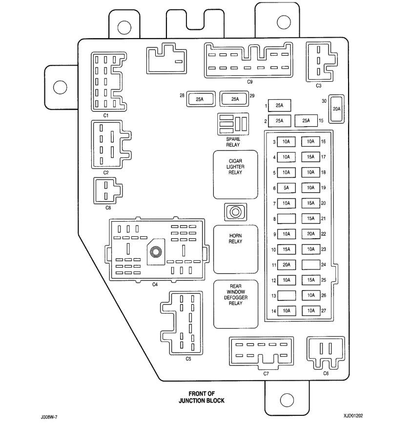

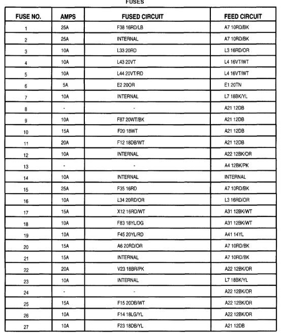

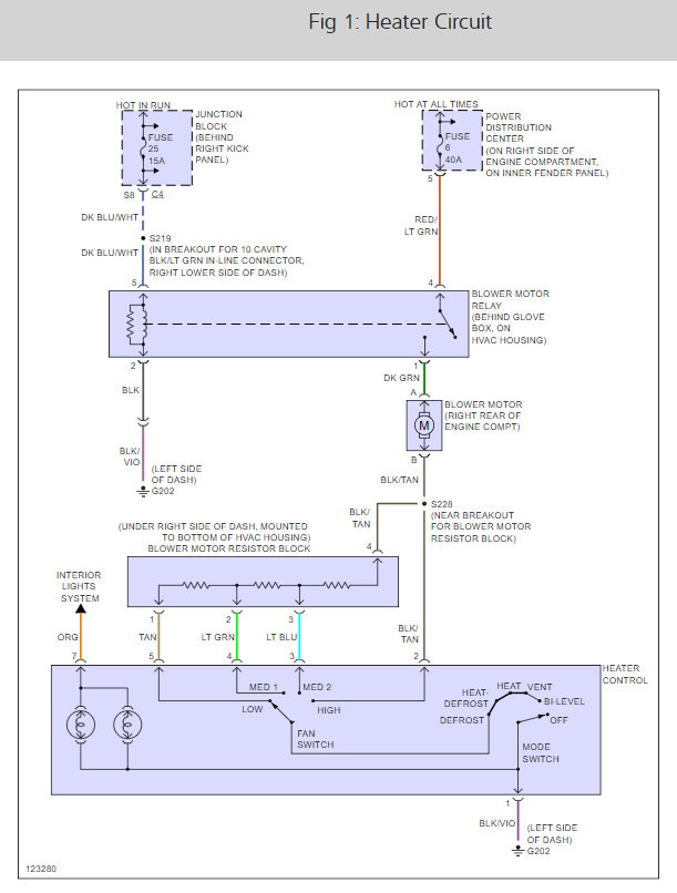

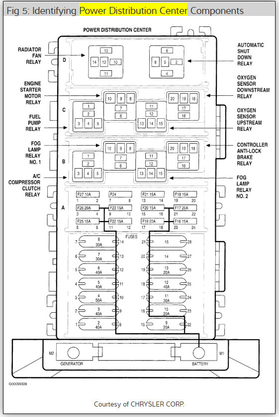

Check for power arriving at the motor with the key on at the black and violet wire. If no power is found check fuse #6 40amp in the engine compartment fuse box and fuse #25 15amp in the under dash fuse box.
If both fuses are good, check the blower relay.

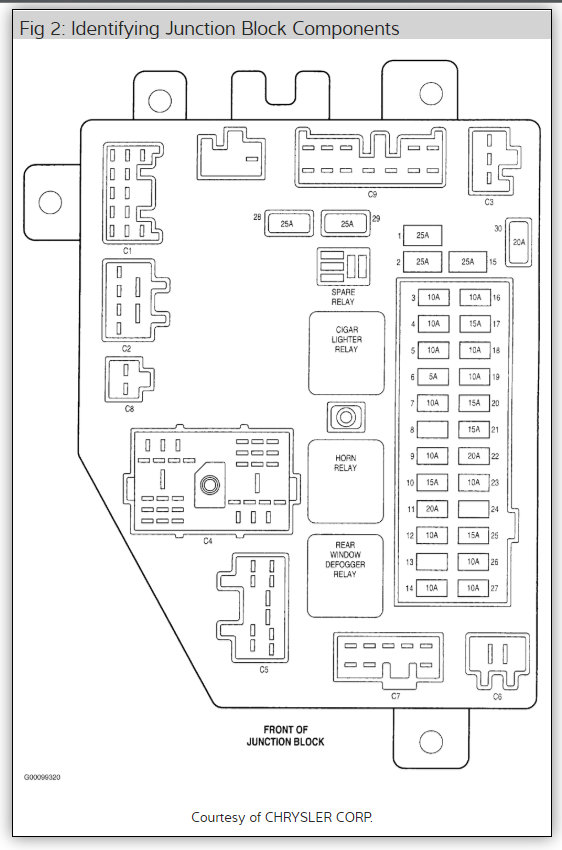

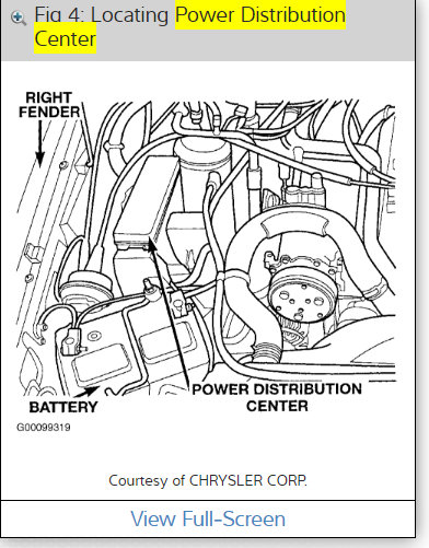

Welcome to the forum. Start by checking fuse 6 and 25. Also check for voltage on the fuse circuit. Fuse 6 is in the power distribution center under the hood.
Here is a guide and the fuse panel locations and identifications.
Cheers

Have checked fuse #7 blower motor is hot all the time switch provides ground

I checked all fuses under hood. #7 gets no power, but fuse still good.
Apr 22, 2019 at 6:14 PM (Merged)
DOCFIXIT
  • 18,828 POSTS
Checking in power distribution chenter? using a meter? do not check across fuse ground to body then test. Fues is direct feed from battery

Yer welcome. Did you check the blower motor relay or fuse?
SERVICE WRITER
  • 9,123 POSTS

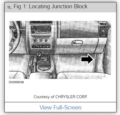

Relay is located in wiring harness connector that is secured to heater housing, behind glove box.
fuse 25 in the junction block.
