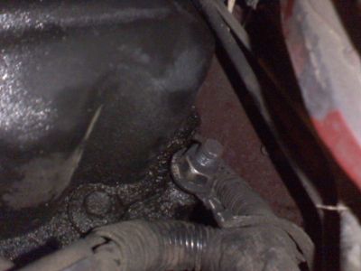

There what appears to be a ground attached at the rear of the valve head cover. A leaky gasket seems to have created some sludge around this ground. Could this be a possible answer for why it runs better when the engine heats up to op temp?

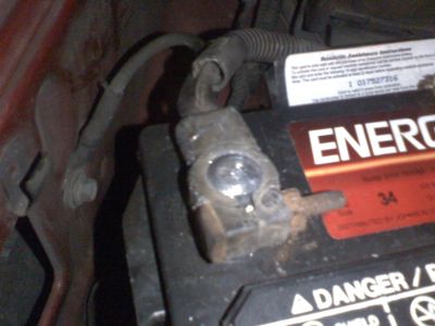

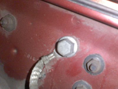

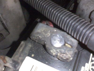

I have found two grounds so far. One on the rear of the engine block connected at the rear of the valve cover to the firewall. The only other one I could find was from the - terminal of the battery to the fender. Where at the best places to look for other grounds? When testing continuity should the multi-meter tone on the bolt holding the ground in place? I have a feeling that the ground covered with sludge is what is causing the problem. If these don't provide the solution what would be the next logical step?

by the looks of the battery terminal ends i would start by replacing them. all you do is cut off the ends and splice in universal battery cable post ends. yours are in rough shape. make sure you have enough wire to connect to the battery after cutting off the old terminal ends.

and on the battery terminals, i find the problem to be in the wire where it connects to the end clamp, you can not clean it because your not getting to where the cable is soldered to the end post.

As for the speedometer, it seemed like cleaning that engine ground in the first picture has solved that problem, but I won't know for a few test drives. In the past, after a 45 min drive on the highway, and letting the vehicle cool down (couple hours), this is when the problems with sputtering and needle bouncing occur. I will be replacing the terminal ends today. Do you recommend any particular type of terminal ends (brand, etc.)?
