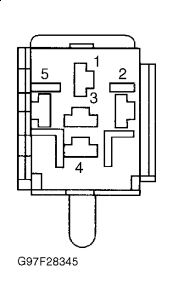

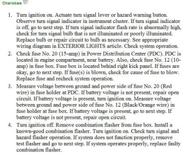

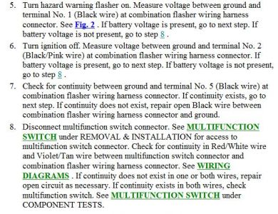

my turn signals use to work.now when i try to use them it make a buzzing sound,my hazzards works,but when i try to use the turn signals i get a buzzing sond.i change the bulbs and check the fuse still nothing.

https://images.2carpros.com/forum/automotive_pictures/55316_99cherokee1_1.jpg
https://images.2carpros.com/forum/automotive_pictures/55316_99cherokee2_1.jpg
https://images.2carpros.com/forum/automotive_pictures/55316_99cherokee2_2.jpg
