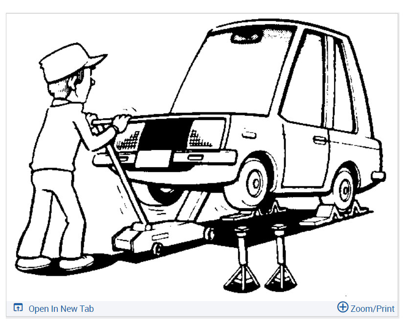

Yep, I agree with RASMATAZ, aslo, you could have an air bubble inside the core as well, here is a guide that will help you fix the problem as well.
Here is how to bleed the air out of the heater core if flushing it with a garden hose does now work. Check out the images (below). Please let us know what happens.
