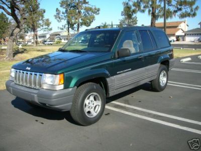

I have a 1993 Jeep Grand Cherokee Laredo with 183,000 miles and the 5.2L motor. Sometimes when I start it, it feels like the motor is missing, possibly not running on all cylinders. Other times it starts up perfectly and will run great for awhile, then it experiences a lack of power, cuts out and lopes on idle, down to 500 rpm on tach. The other day, it started great, ran great into town, then started missing, loss of power, etc. Got so bad when I accelerated, the steering wheel was shaking badly. Limped home. Parked it. Today, it starts fine, went around the block, no problems, runs normal, engine sounds and feels good and normal exceleration ! I am afraid to drive it right now because I don't know when or where it will start doing it again! I have only owned it for a month, but it came with excellent maintenance records. I tried the on/off/on/off/on watch engine light and count how many times it flashes for code number, but it only flashes 5 times and then 5 more times. What does that mean, code 10 ? Well, the codes I downloaded start at 11.....Any help you can give will be appreciated and I am giving a donation! Great service! Thanks, Vance.

Hey deepone3,
That is actually a code 55 which just states that their are no more codes. If that is the only code you get, then there are none. I would try checking the plug wires. If they look old or dirty, try changing those. They are pretty cheap. After that I might try checking the spark plugs and coil. Let us know if this helps.

Steve,
If it was plugs, coil, wires, etc. it would be doing it all the time, right? It seems to only occur when the Jeep is warmed up, say after 10-15 minutes of driving!

Maybe, once electrical "stuff" gets warmed up, it's resistance changes and just that little bit on a part that is already close to failure can cause it to fail. It can't hurt to check them out, especially with that many miles.
If you have these maintenance records, check what has been done to it in the last couple of years.
Also, the PCM uses different sensor signals to adjust air/fuel mixture when it is warm as opposed to when it is cold. But if a sensor was bad, you would be getting some trouble codes. I'm surprised there are none with a problem that bad.
Check the wires and such. If they all check out, let it idle and see if you eventually get a trouble code.
