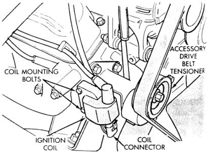

Ok now thats a good thing heres how to test coil along with removel and install
TESTING
See Figures 1 and 2
The ignition coil is designed to operate without an external ballast resistor. Inspect the coil for arcing. Test the coil primary and secondary resistance.
Measure the primary resistance as follows:
Connect an ohmmeter between the positive (+) and negative (-) terminals (the terminals which are connected to the engine wiring harness) on the coil.
To test the secondary resistance, connect an ohmmeter between the positive (+) coil terminal and the high voltage cable terminal on the coil, then measure the resistance between the positive (+) coil terminal and the coil case; the resistance for the case should exhibit infinite resistance.
For coils manufactured by Diamond, the primary resistance at 70-80 °F (21-27 °C) should be 0.97-1.18 ohms and the secondary resistance should be 11,300-15,300 ohms.
Coils built by the Toyodenso company should exhibit a primary resistance at 70-80 °F (21-27 °C) of 0.95-1.20 ohms and a secondary resistance of 11,300-13,300 ohms.
Replace any coil with a new one if it does not meet the specifications.
https://www.2carpros.com/forum/automotive_pictures/52960_0900c152800a986f_1.jpg
Fig. 1: Ignition coil and related components-4.0L model shown

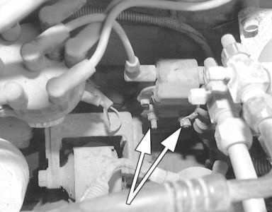

https://www.2carpros.com/forum/automotive_pictures/52960_0900c152800a9870_1.jpg
Fig. 2: Ignition coil and related components-5.2L/5.9L model shown

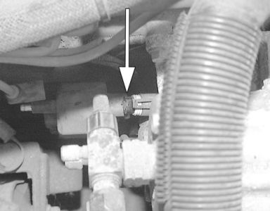

https://www.2carpros.com/forum/automotive_pictures/52960_0900c152800a9871_1.jpg
Fig. 3: Disconnect the coil wire from the ignition coil tower

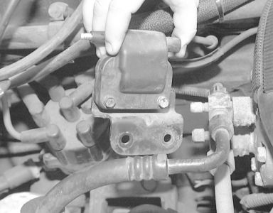

https://www.2carpros.com/forum/automotive_pictures/52960_0900c152800a9872_1.jpg
Fig. 4: Disconnect the wiring harness from the side of the ignition coil
Make sure that the ignition switch is in the OFF position.
Disengage the negative battery cable.

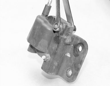

https://www.2carpros.com/forum/automotive_pictures/52960_0900c152800a9873_1.jpg
Fig. 5: Remove the left ignition coil bracket mounting stud and wiring harness retaining loop nut

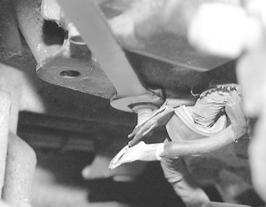

https://www.2carpros.com/forum/automotive_pictures/52960_0900c152800a9874_1.jpg
Fig. 6: After removing the wiring harness nut, remove the ignition coil mounting bracket stud ...
