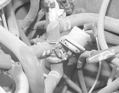

Please help me identify this part (I'm a beginner.) It has heating hoses connecting to it, and the top black plastic "cap" is cracked in half (center of picture attached.) What is this part called? It's located in the back left of the engine, with some of the hoses going into the wall in front of the passenger seat. Thank you so much.

The part is called the heater water control valve.
it is is spliced into the heater core hoses along with a vacuum hose to open and close the valve.
