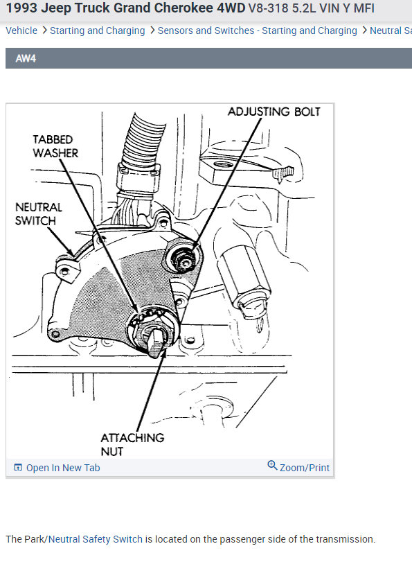

My jeep does not start in park have to put it in neutral before I start I can start. Also the front right side wheel rackles when it drop in a pot hole. Could you help me.
Tuesday, March 17th, 2009 AT 9:34 AM
SQM
  • 6,383 POSTS

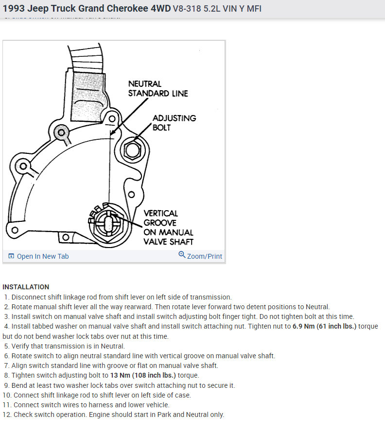

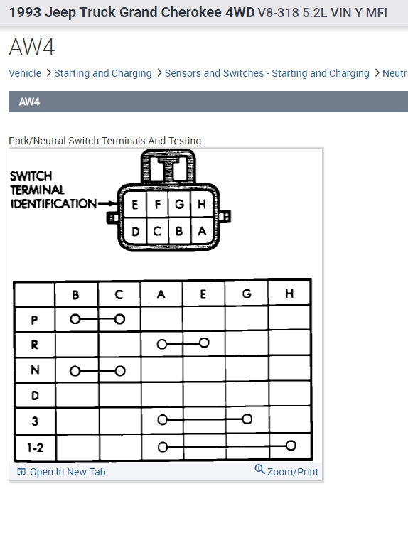

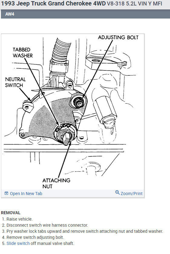

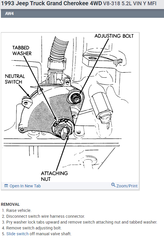

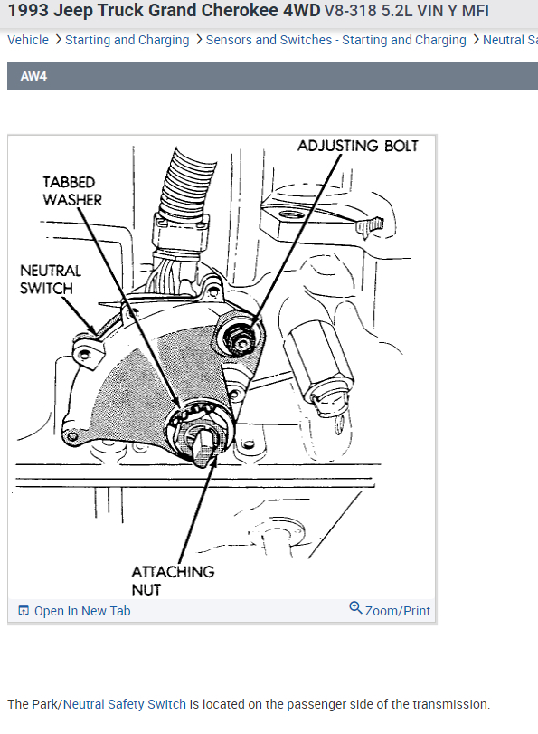

It sounds like you might have faulty neutral safety switch.
Typically when that switch goes bad you will have to put in neutral to start.
The neutral safety switch is located on the passenger side of the transmission.

I have attached the neutral safety switch diagrams for your reference.
