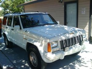

I have a 1991 Jeep Limited cherokee. It's running rough. Check engine code reads hi/low voltage to TPS sensor. I've tried 4 new tps sensors still does the same thing. sometimes it runs just fine. Other times for no reason it runs really rough, bogs down, rpms jump around.. Any ideas? I replaced the MAP sensor, air filter, engine temp sensor, new plugs/wires, new battery, new alternator, new muffler, no results.
