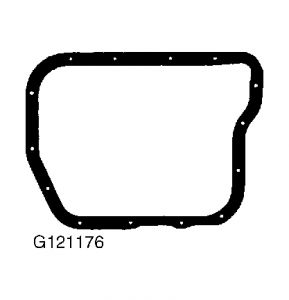

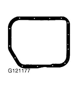

I have a 90 Cherokee with the vaccume transfer case system (no id tag so not sure what is exactly) and ripped out third and forth gear. so i bought an 89 cherokee to switch trannys but niether of them still have the id tag on the tranny and i cant tell if they are the same, they look the same but im not sure if they will bolt up the transfer case beacuse the 89 has a np242 t-case which does not have the vaccume setup is there any way to tell if would work other than just takin out and tryin it...

There were two trannys an Aisin and a peugoet, Check the shape and bolt patterns on the oil pans. it should fit either way.
