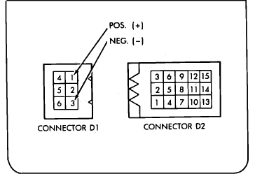

I can't find a schematic showing the sensor connections to check if I have them all connected correctly.

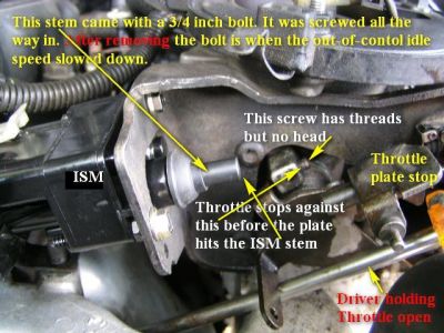

The new Idle Speed Motor came with a hex head bolt that when screwed all the way down did not slow the runnaway idle any but after I removed it the idle went down to normal but still after warming up remained somewhere around 12 to 15 hundred R's (only a guess), but it's now down to something I can deal with.

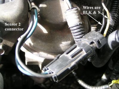

There's three sensors connected to the Intake manifold and if I have them connect to the wrong connector that could cause the on board computer to give some false reading, couldn't it? But on your suggestion I'll keep looking for a vacuum leak.
Thanks. Jay
Sunday, September 19th, 2010 AT 12:56 AM
KHLOW2008
  • 41,814 POSTS
Hi Jay,
If the 3 sensors are connected wrongly at the the intake manifold, they can cause the engine to perform erratically.
What are the wire colors for each of the connectors?
Did you try to adjust the ISA?
You mentioned taking pictures of the parts around the throttle body, that should help.
Sunday, September 19th, 2010 AT 10:25 AM

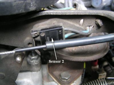

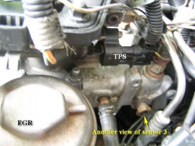

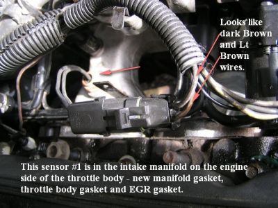

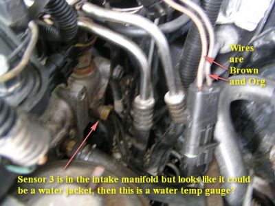

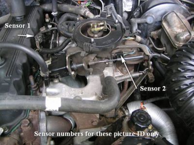

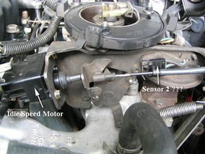

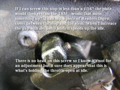

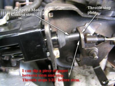

Oh my, I answered some question on this reply and sent some pictures then when I hit the preview button I lost the whole thing.
This engine is running to well for it to be the TPS after what you told me about it. I installed a new manifold gasket and one under the throttle body and EGR valve. I would not rule out a leak at these points but there's nothing that indicates they are leaking.
I will send a 5 pictures, this time not to Preview. Just hope you get em. Thanks a whole lot for your help. Jay

+1
Monday, September 20th, 2010 AT 8:07 PM
  • 109,885 POSTS
I checked a schematic and everything looks correct. I hate to say it, but I'm at a loss. If you disconnect the idle speed motor, does that change anything?
FYI: I'm going to ask another tech to look at this and see what he says.

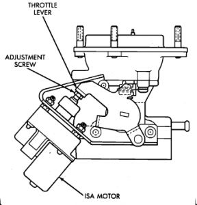

Try dropping the idle speed thru the ISA-plunger
https://www.2carpros.com/forum/automotive_pictures/12900_isa_jeep_1.jpg
Adjustments
This adjustment is only required after the ISA motor has been replaced, and is only used to establish the initial position of the actuator.
NOTE:An ISA Exerciser Tool (Part No. Ele. AB.99) is required to successfully complete the adjustment of the ISA motor. Slight modification to the ISA Exerciser Tool (Part No. Ele. AB.99) connector may be required so that it can be connected to the ISA motor. Use a hobby knife, and cut grooves in the casing of terminal (A) that match the grooves in the terminal casing of terminals (D) and (B).

Diagnostic Connector Identification
https://www.2carpros.com/forum/automotive_pictures/12900_isa_1.gif
Connect a tachometer across diagnostic connector D1 terminals 1 and 3.
Disconnect the Idle Speed Actuator (ISA) electrical connector from the motor.
Connect the ISA Exerciser Tool (Part No. Ele. AB.99) to the ISA motor.
Using the Exerciser Tool, extend the ISA plunger fully.
Idle Speed Actuator (ISA) Motor Adjustment
Turn the Adjustment screw, while watching the tachometer, until the engine speed is 3500 rpm.
Disconnect and remove the ISA Exerciser Tool (Part No. Ele. AB.99) and connect the ISA electrical connector. Idle speed should return to normal after a few seconds.
