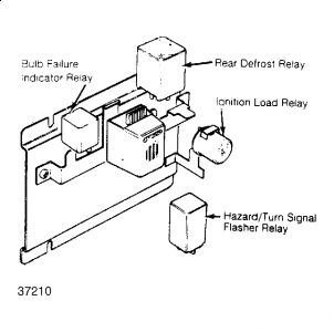

I recently bought an 86 XJ6 from the original owner and, at first ,the only issue I had (and still do) is with the turn signals, sometimes they work, sometimes they don't. I was able to change all of the fuses, except for the 35 and 50 (watt/volt?) as AutoZone nor Kragen didn't offer anything higher than 30. I am using ACG fuses, although there might be a few 20 SFE, and I am not sure if that makes a difference. I need to know where to get the fuses I need and need to make sure I am getting the correct type/size.

Yes .. any Jaguar dealer will supply the fuses .. I think your problem may lie in the actual turn signal switch or relay ! ... I would return the car to the jiffy lube and have them check the hoses, explain you had no leak before the flush .. it is really their responsibility to fix the leak. Turn Signal/Hazard Flasher Relay...Under right side of instrument panel.
