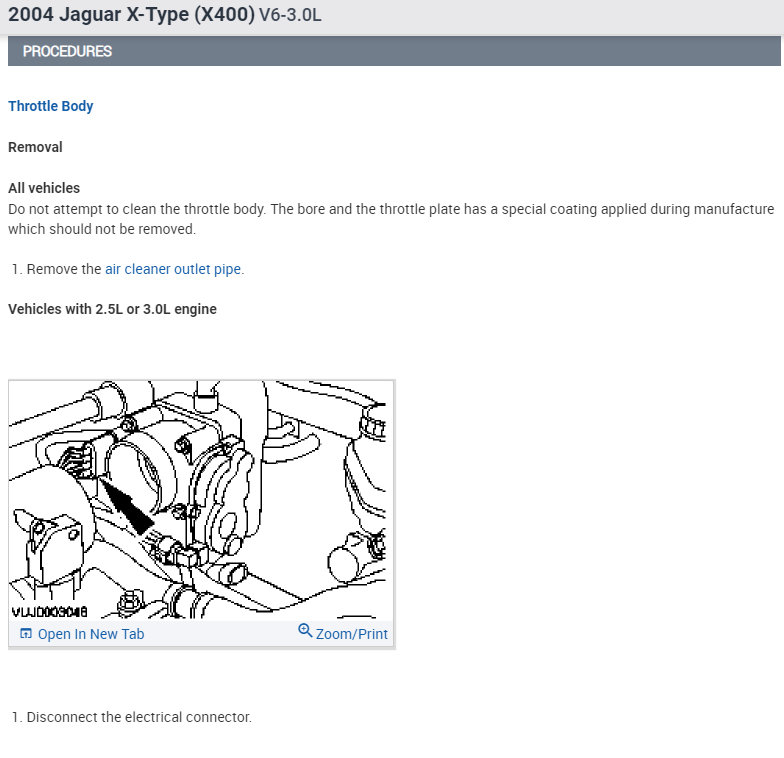

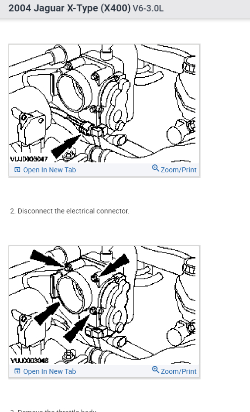

i have a 2004 jag xtype 3.0 awd all of a sudden while driving the car will lose power but still run with trans light then engine light. you have to turn the car off and then back on and its fine. its happened 3x in 4 days. please help . thanks

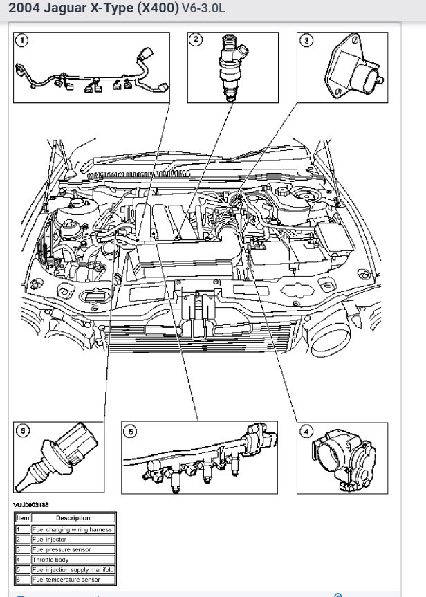

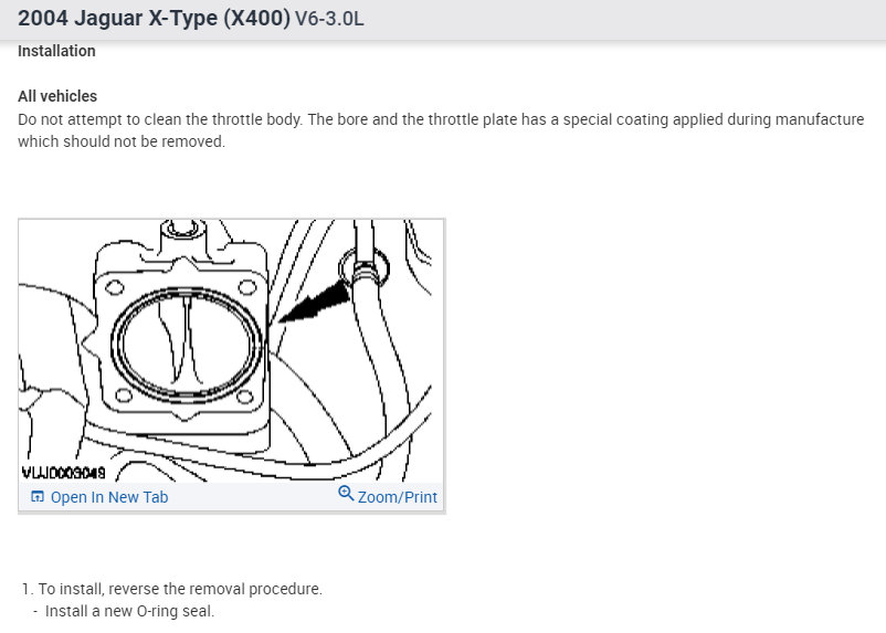

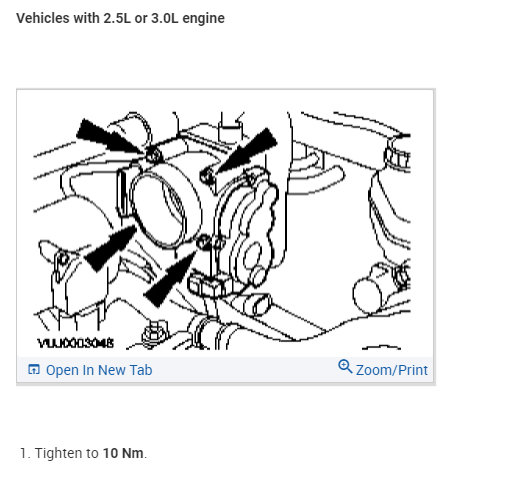

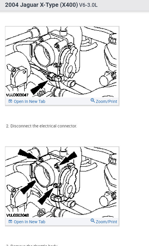

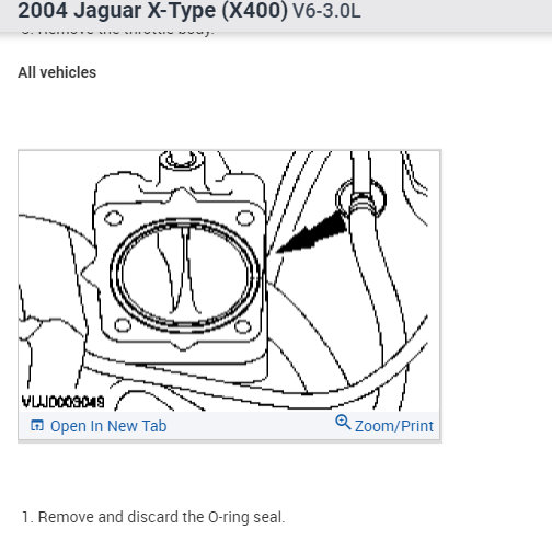

One of the common reasons for an engine to go into low power or limp mode is a dirty throttle actuator. Over time the throttle actuator can have dirt and debris built up inside. Which can cause it to send incorrect data to the ECM and that could trigger the limp mode.
https://www.2carpros.com/articles/reduced-power-limp-mode
Many times, cleaning out the throttle bore can improve the drivability.
Here is a helpful guide on how to clean the throttle body:
