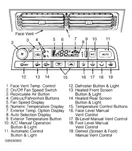

Hello .. thanks for the donation .. much appreciated The HVAC system has a self-diagnostic system which should tell you where the actual fault lies .. hope this helps ... let me know if you require more information or assistance ! SELF-DIAGNOSTICS NOTE:Specific circuit and component testing procedures are not available. Manufacturer recommends using Portable Diagnostic Unit (PDU) for circuit and component fault diagnosis. A/C-heater control panel contains a self-diagnostic function. A/C-heater control panel can store up to 5 A/CCM trouble codes at a time. When a system fault occurs, A/CCM stores information about the event in memory. Upon next ignition cycle, a beep will be heard and ER (error) will be displayed for 5 seconds on A/C-heater control panel. RETRIEVING DIAGNOSTIC TROUBLE CODES NOTE:Diagnostic Trouble Codes (DTC) can be retrieved using Jaguar Portable Diagnostic Unit (PDU) or a scan tool. If not available, A/C-heater control panel DTCs can be retrieved using on-board diagnosis incorporated in A/CCM. PDU diagnosis is more comprehensive than A/C-heater control panel diagnosis. System Self-Diagnostic Test A/C-heater control panel display will flash repeatedly indicating a list of 2-digit numbers. See DIAGNOSTIC TROUBLE CODE DEFINITIONS table. This procedure must be completed in order, through one complete cycle: Display Element Check Turn ignition switch to OFF position. Simultaneously press and hold AUTO and RECIRC buttons. See Fig. 1 . Turn ignition switch to ON position while holding buttons. All display elements should illuminate and segments will flash on and off. If any display elements or segments do not light, an A/C-heater control panel or light fault is indicated. Display Stored Numeric Trouble Code(s) (1)
https://images.2carpros.com/forum/automotive_pictures/266999_1_12.jpg
Press AUTO button. A 2-digit trouble code will be displayed. Codes 11, 15 and 21, will cause audible beep and ER to be displayed. If zero appears, there are no stored trouble codes, wait 30 seconds to allow system self-test to finish. A trouble code followed by a beep indicates an active trouble code. A trouble code not followed by a beep indicates an inactive trouble code stored in memory. Scroll Through Trouble Code(s) Press face button to display stored trouble codes. A maximum of 5 trouble codes can be stored. Clear Stored Trouble Code(s) Simultaneously press face and "R" (heated rear screen) buttons. It may be necessary to press face and "R" buttons to clear each stored trouble code. NOTE:Actuator codes are not system trouble codes. See ACTUATOR CHECK under TROUBLE SHOOTING. Initiate Actuator Check Press RECIRC button to initiate actuator check. Actuator codes 20 through 27. Press fan to skip actuator check. Exit System Self-Diagnostic Test Press fan button to exit system self-diagnostic test. Press PUSH OFF button to restore normal operation. DIAGNOSTIC TROUBLE CODE DEFINITIONS DTC ...(Panel DTC)...Component ..(0)......................(1) Normal Operation P0335 ..(.....)......... Engine Speed Input B1250... (11) .........In-Vehicle Temperature Sensor B1253... (11)......... In-Vehicle Temperature Sensor B1254... (12)......... Ambient Temperature Sensor B1257 ...(12) .........Ambient Temperature Sensor B1258... (21)......... Solar Sensor B1260 ...(21)......... Solar Sensor B1262... (44) ........(2) Defrost Servo Motor B1263... (45) ........(2) Center Vent Servo Motor B1264 ...(46) ........(2) Foot Servo Motor B1265... (43)........ (2) Cool Air By-Pass Servo Motor B1266... (41) ........(2) Left Fresh/Recirculated Air .................................Servo Motor B1267... (42)........ (2) Right Fresh/Recirculated Air ................................ Servo Motor B1268... (34)......... (3) Defrost Vent Feedback ....................Potentiometer B1271... (34) .........(3) Defrost Vent Feedback ..................................Potentiometer B1272... (35).......... (3) Center Vent Feedback .................................. Potentiometer B1275 ...(35).......... (3) Center Vent Feedback ...................................Potentiometer B1276 ...(36) ...........(3) Foot Vent Feedback ....................................Potentiometer B1279... (36) ...........(3) Foot Vent Feedback ....................................Potentiometer B1280... (33) ...........(3) Cool Air By-Pass Feedback ................................... Potentiometer B1283... (33)........... (3) Cool Air By-Pass Feedback ................................... Potentiometer B1284.... (31).......... (3) Left Fresh/Recirculated Air ................................... Feedback Potentiometer B1287 ....(31) ...........(3) Left Fresh/Recirculated Air .................................... Feedback Potentiometer B1288.... (32) ...........(3)Right Fresh/Recirculated Air ................................... Feedback Potentiometer B1291.... (32)........... (3) Right Fresh/Recirculated ..................................Air Feedback Potentiometer B1292.... (.....)............. Battery Voltage Supply .................................. Through A/C Isolate Relay B1294.... (.....) .............Battery Voltage Supply ...................................Through A/C Isolate Relay B1297.... (.....) ......Sensor 5-Volt Reference Voltage B1298.... (.....)...... Sensor 5-Volt Reference Voltage B1299.... (.....) ......Sensor 5-Volt Reference Voltage B1355.... (.....)...... Battery Voltage Supply B1849..... (24) ......Face Vent Differential .............................Temperature Control B1852..... (24) ......Face Vent Differential ........................... Temperature Control B1853.... (.....)...... Aspirator Motor B1856.... (.....) ......Aspirator Motor B1857 ....(.....)...... Ignition Switched (AUX/ON) ........................... Ground Signal B1858..... (23)..... (4) Refrigerant Dual Pressure ................................Switch B1861..... (23)..... (4) Refrigerant Dual Pressure ................................Switch B1862 .....(22) ...........Compressor Lock Signal B1863 ....(.....) ...........Sensor Signal Ground B1946..... (13)........... Evaporator Temperature ................................ Sensor B1947..... (13)...... Evaporator Temperature Sensor B1948...... (14)...... Coolant Temperature Sensor ........................... Signal B1949 .....(14)....... Coolant Temperature Sensor ............................... Signal B1966 .....(15)........ Heater Matrix Temperature .............................. Sensor B1967..... (15)........ Heater Matrix Temperature ............................. Sensor B1968 .....(.....) ......Heater Pump B1969..... (.....)...... Compressor Clutch Circuit U1263..... (.....)....... Control Panel Serial ............................. Communication U1264..... (.....)....... Control Panel Serial ..............................Communication (1)When there are no DTCs, WAIT 30 seconds for system self-diagnostic test to finish. (2)Check for an open or short in motor drive circuit, or a sticking/jammed motor flap. (3)Open or short in potentiometer feed circuit. At times, motor may overrun and set additional codes. Cycling ignition on and off 2 or 3 times may correct problem. (4)Temperatures less than 32 °F (0 °C) may set false trouble code due to low refrigerant pressure. Temperatures greater than 95 °F (35 °C) may set false trouble code due to temporary high refrigerant pressure. Repair faults before clearing DTC's CLEARING DIAGNOSTIC TROUBLE CODES To clear trouble codes, turn ignition to ON position. Simultaneously press face and "R" (heated rear screen) buttons. It may be necessary to press face and "R" buttons to clear each stored trouble code. Press fan button to exit system self-diagnostic test. Press PUSH OFF button to restore normal operation. See Fig. 1 .

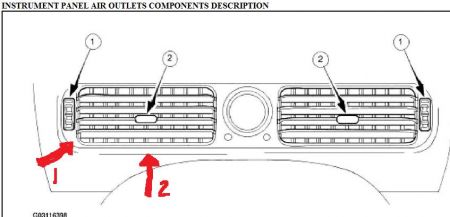

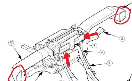

DAVE H
  • 13,383 POSTS
Hello Let me just check I am understanding your fault correctly .. you are getting a mixture of warm and cold air from the same vents marked with red arrows ..where my #1 arrow is you are getting warm air and where my #2 arrow is you are getting cold air with the temp set at it's lowest ? What about the side vent's (circled) .. also have you cleaned or replaced the air/pollen filters recently at the bottom of the windscreen (outside)
https://images.2carpros.com/forum/automotive_pictures/266999_vent2_1.jpg
https://images.2carpros.com/forum/automotive_pictures/266999_vent_1.jpg

NICOLO
  • 11 POSTS
Hi
I am getting cold and warm from the same center vents, has you have marked , the part near the clock , cold the other half ,warm,(for both vents on each side of the clock) this for both certer vents.
The side vents are warm, the foot vents VERY warm.
