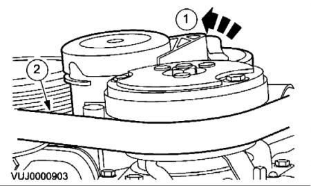

6.Detach the accessory drive belt from the air conditioning (A/C) compressor and generator pulleys.
https://images.2carpros.com/forum/automotive_pictures/12900_op2_1.gif

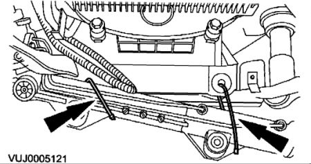

7.Detach the A/C compressor. Using a suitable tie strap, tie the A/C compressor aside.
https://images.2carpros.com/forum/automotive_pictures/12900_op3_1.jpg

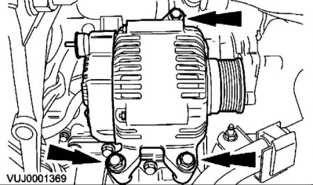

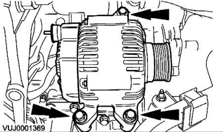

8.Detach the generator. Using a suitable tie strap, tie the generator aside. 9.Drain the engine oil.
https://images.2carpros.com/forum/automotive_pictures/12900_op4_2.jpg

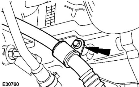

10.Detach the power steering hose.
https://images.2carpros.com/forum/automotive_pictures/12900_op5_1.jpg

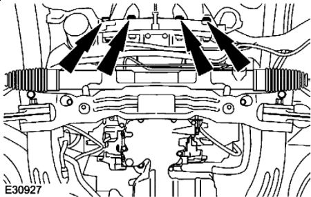

11.Detach the steering gear.
https://images.2carpros.com/forum/automotive_pictures/12900_op6_1.jpg

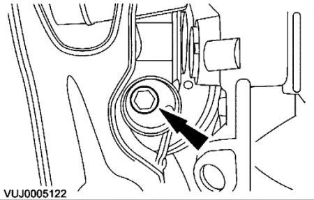

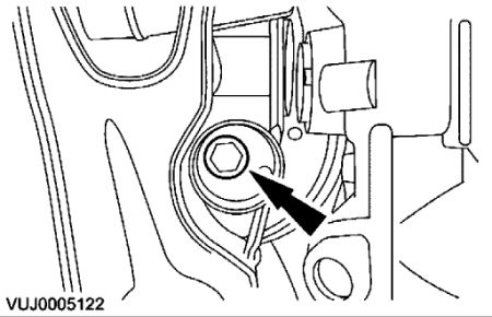

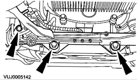

12.NOTE: Left-hand engine mount lower retaining bolt shown, right-hand similar.
https://images.2carpros.com/forum/automotive_pictures/12900_op7_1.jpg

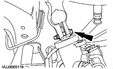

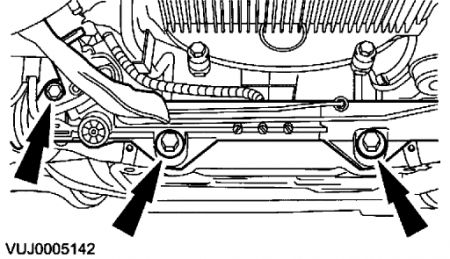

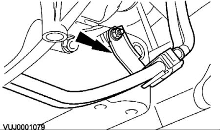

13.Remove the engine mounts lower retaining bolts. Vehicles with Automatic Transmission
https://images.2carpros.com/forum/automotive_pictures/12900_op8_1.jpg

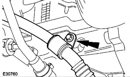

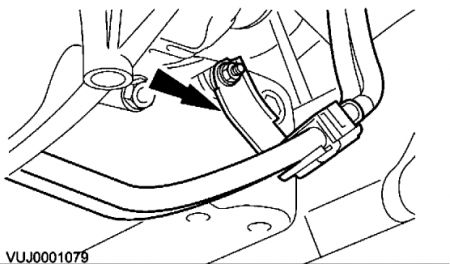

14.Detach the automatic transmission oil cooler tubes retaining bracket. All Vehicles 15.Support the engine and transmission using a suitable transmission jack or axle stand. Position the support on the transmission bell housing behind the oil pan.
https://images.2carpros.com/forum/automotive_pictures/12900_op9_1.jpg

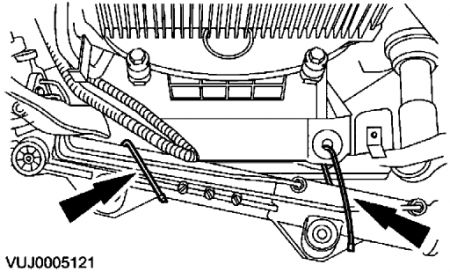

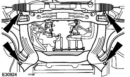

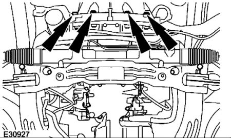

16.WARNING: DO NOT REMOVE THE FRONT SUBFRAME RETAINING BOLTS. FAILURE TO FOLLOW THIS PROCEDURE MAY RESULT IN PERSONAL INJURY. Loosen the front subframe retaining bolts to enable the oil pan to be removed.
https://images.2carpros.com/forum/automotive_pictures/12900_op10_1.jpg

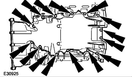

17.Remove the oil pan rear retaining bolts. 18.Remove the oil pan. *Remove and discard the oil pan gasket. *Clean and inspect the oil pan and cylinder block sealing surfaces using Metal surface cleaner or equivalent meeting Jaguar specification. Installation
https://images.2carpros.com/forum/automotive_pictures/12900_op11_1.jpg

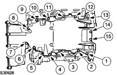

All Vehicles 1.NOTE: Apply an 10 mm dot of silicone gasket and sealant meeting Jaguar specification to the engine block and front cover mating surface. NOTE: Loosely install the oil pan to transmission housing bolts. NOTE: Tighten all oil pan retaining bolts with in six minutes of applying the sealer. Install the oil pan rear retaining bolts. *Complete the tightening sequence. *Tighten to 25 Nm .
https://images.2carpros.com/forum/automotive_pictures/12900_op12_1.jpg
