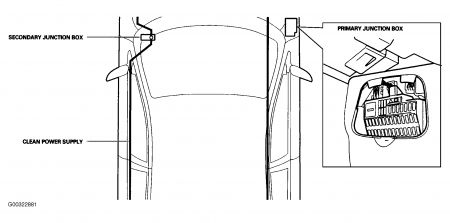

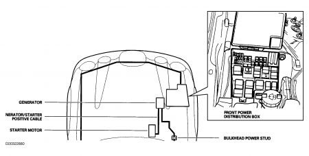

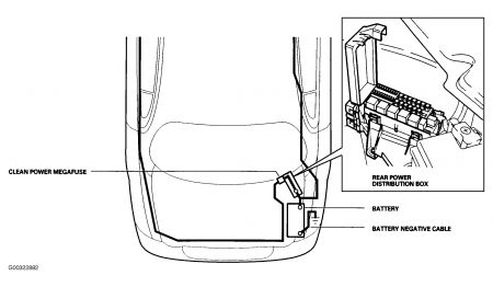

I took my jaguar in for an oil change and drove it for about five hour afterward and parked it. The next day in the late evening got in and turn the key to start it and it was completely dead no lights no sound. Just completely dead and want do nothing at all. I had the battery check and it show no sign of being down. I am unable to use the remote control to open and lock the doors as well as set the alarm. NOTHING comes on it is completely dead as if no engine is in it. I'm a woman that don't know if something possibly happen when oil was being changed because it seem all of a sudden. What could be wrong?

check all fuses .. especially fuse #F22 in rear (near battery) fuse box ! you could try replacing the battery with a new one ... sometimes if a cell inside the battery is faulty you get a wrong reading ! try these and let me know ?
https://www.2carpros.com/forum/automotive_pictures/266999_bat_2.jpg
https://www.2carpros.com/forum/automotive_pictures/266999_bat2_1.jpg
