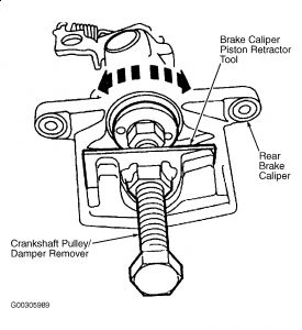

Is there any special way to push the piston back into the caliper. I tried everything and can't get it to go. Please help

NOTE:The left rear brake caliper piston retracts counterclockwise and the right rear caliper piston retracts clockwise.
Using the Brake Caliper Piston Retractor Tool (206-080) and Crankshaft Pulley/Damper Remover (303-588), fully retract the rear brake caliper piston into the caliper housing. See Fig. 64 .
