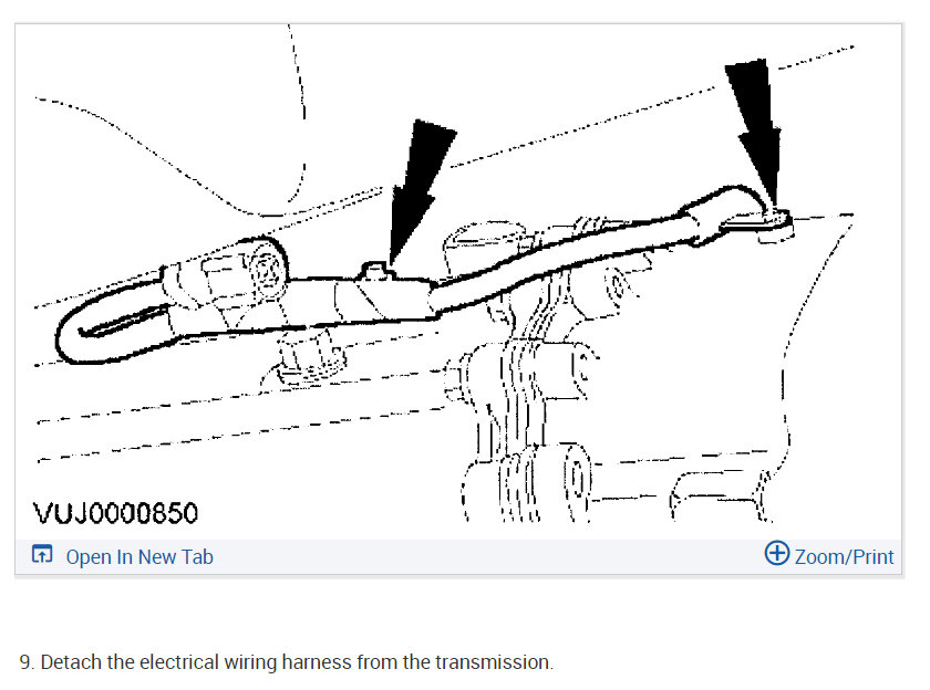

i recently had a my car serviced and new clutch fitted (complete). by the way all services were done - by recognised jaguar dealers (s.africa) - 2 days after i received my car back from dealer - my car switch off completely no lights no power - nothing.

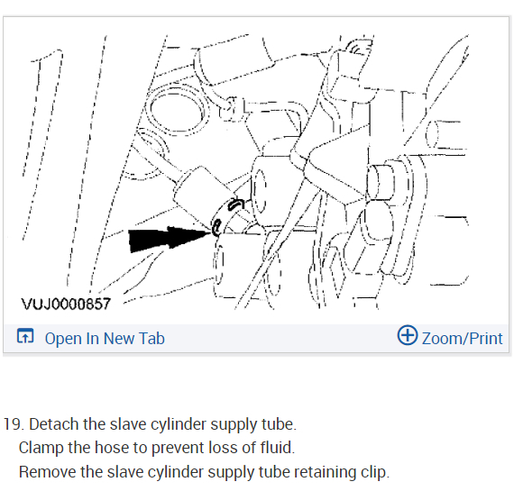

the car was towed back and they discovered wires loose near gear box....1 week later i got stuck again.... i was told that a hydraulic pipe burst and that caused my clutch to fail...once again they fix the problem....3 weeks later i reported to the dealer and told that my clutch feels extremely light.... the car was once again tested and they said it was perfect...
just recently i have taken the car back to their workshop- smells like clucth burning and the car shudders in first gear. all this has happed in a space of three months - after complete service & clutch replaced.
i must also state that i have been driving cars for the last 25 years and i have never experienced this problem before......please help.....

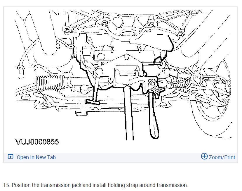

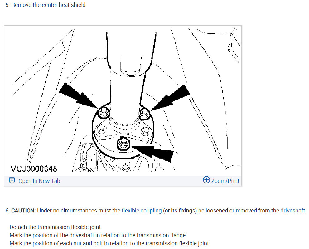

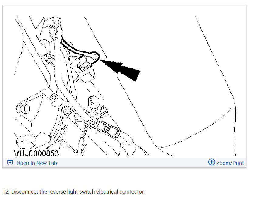

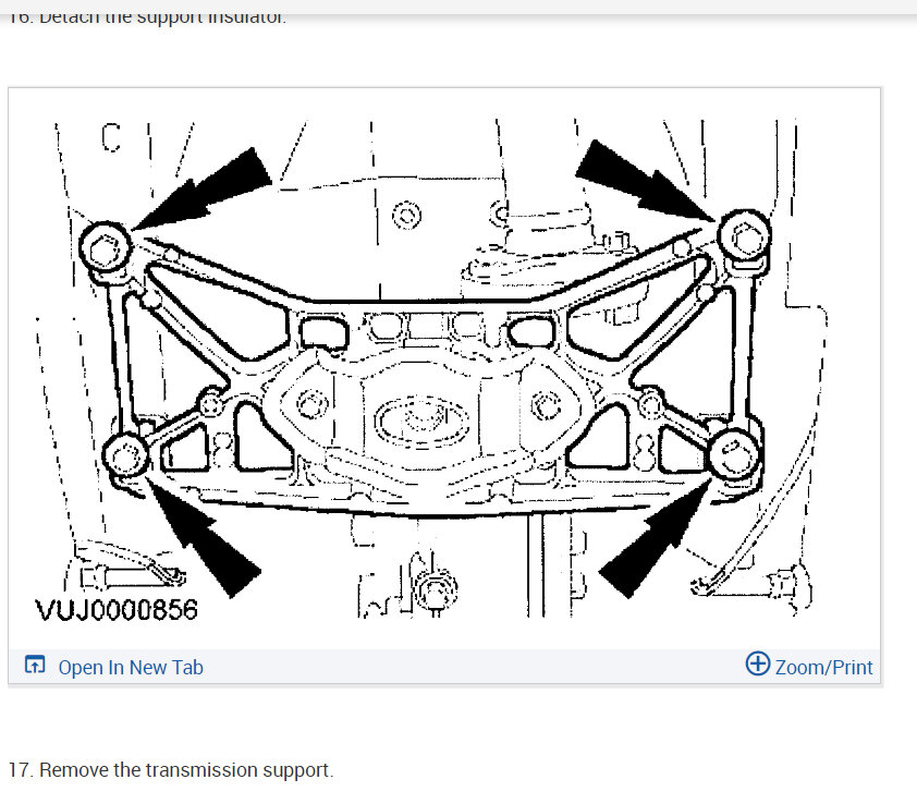

have the dealer replace the clutch again under the warrenty
Oct 25, 2009 at 5:55 AM
  • 55,433 POSTS

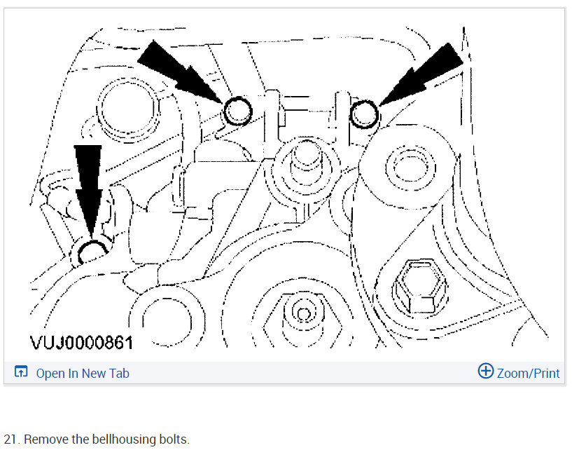

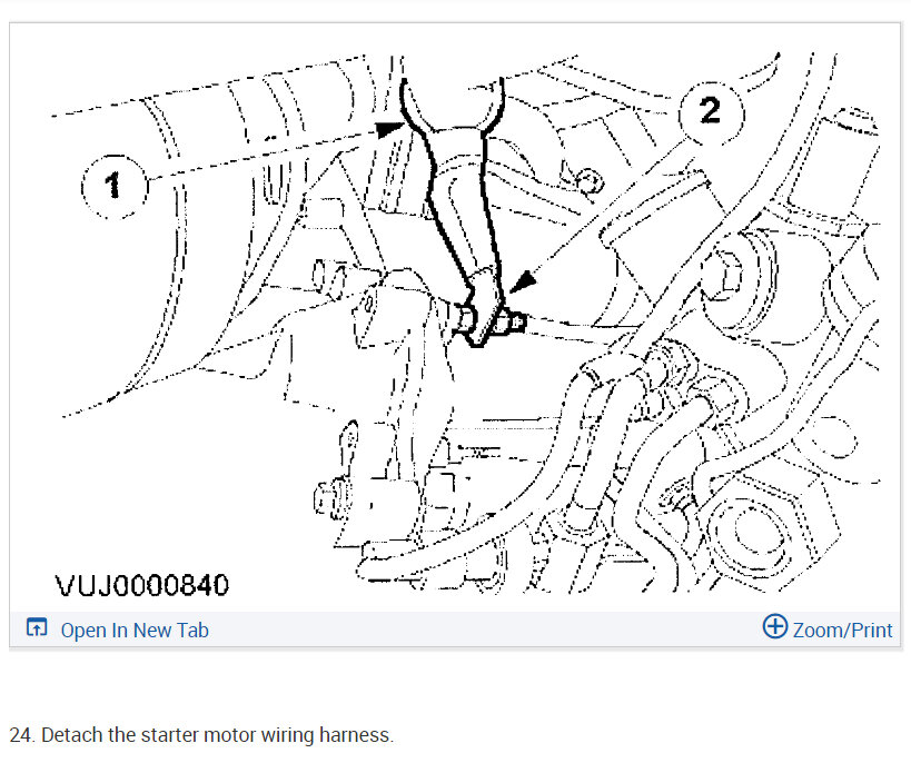

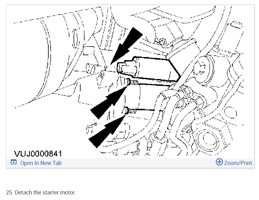

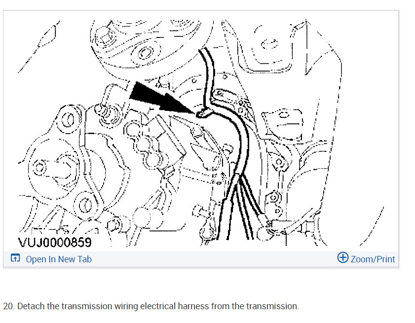

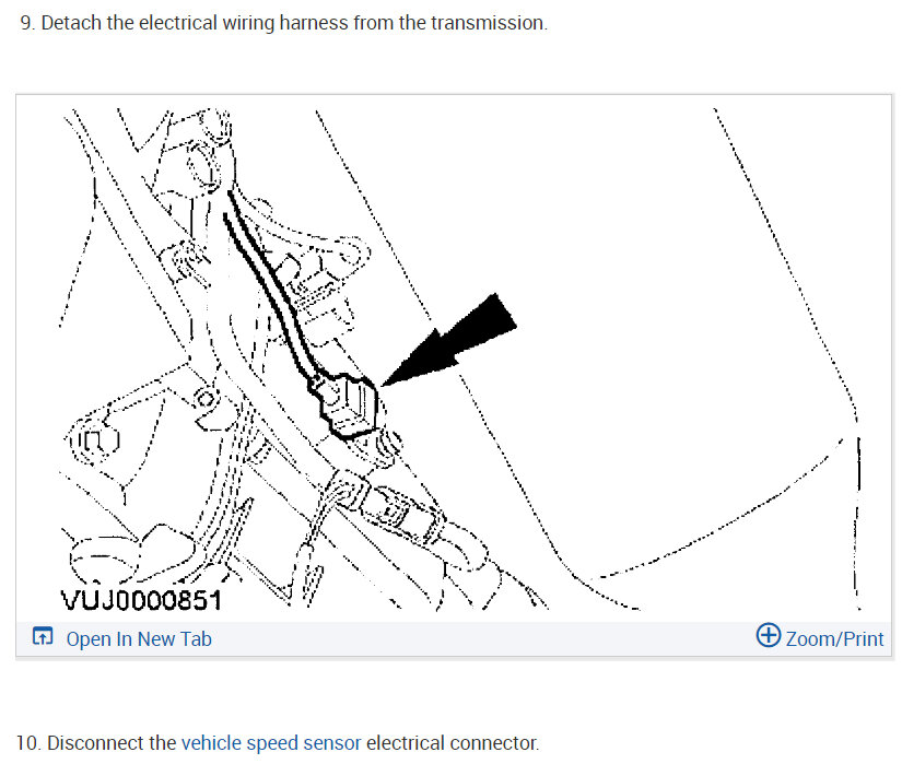

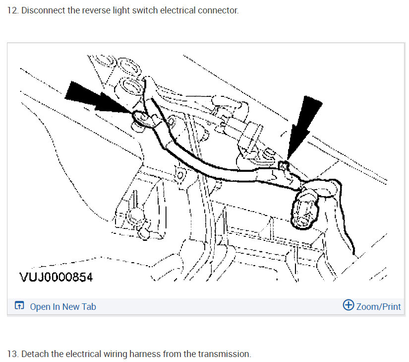

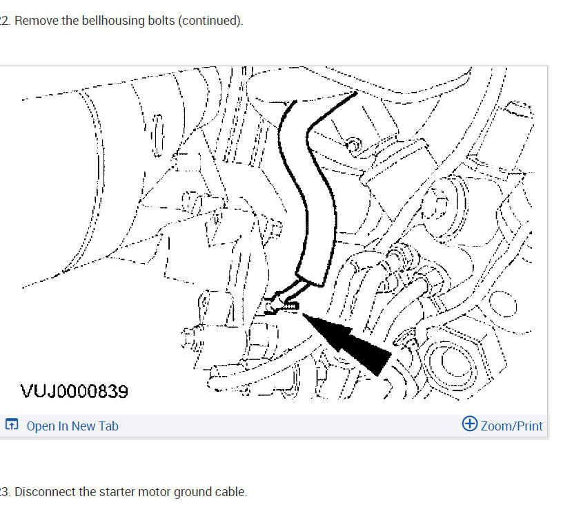

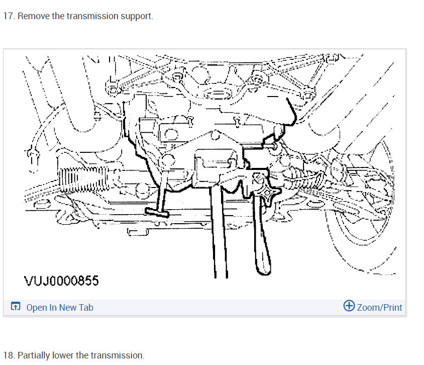

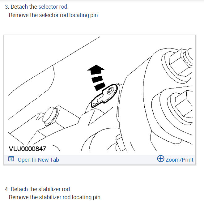

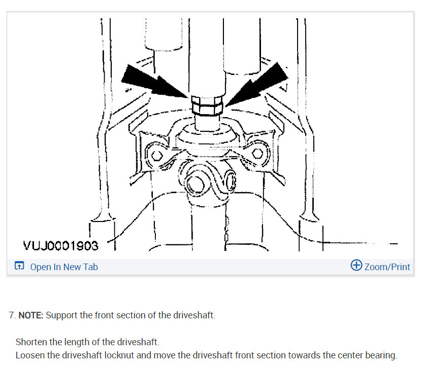

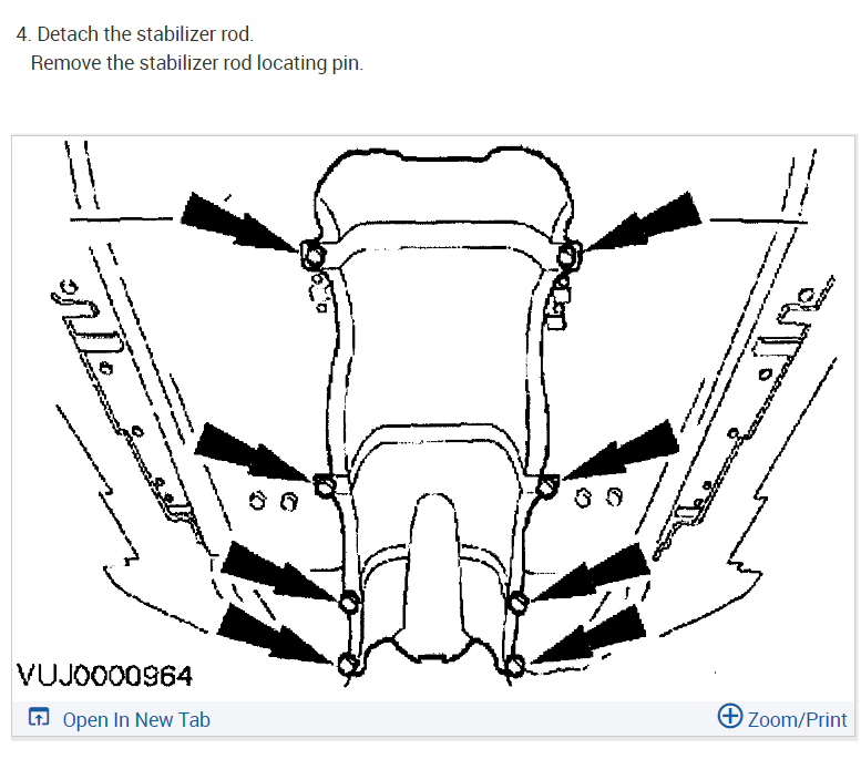

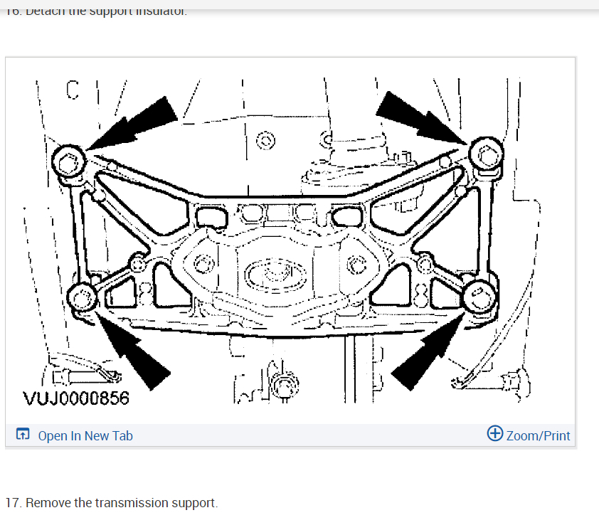

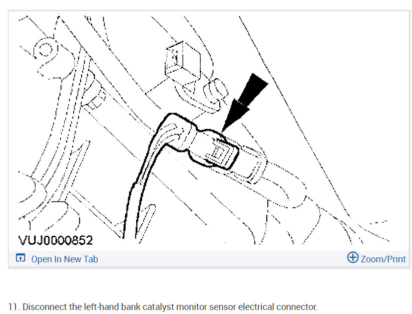

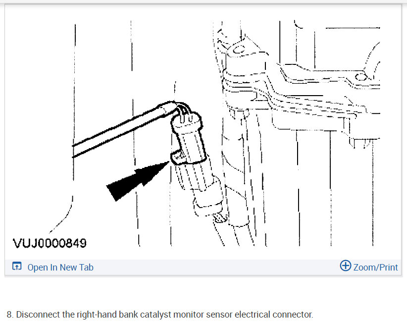

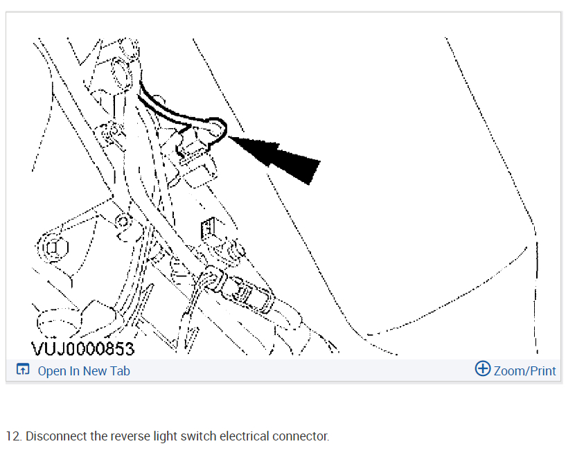

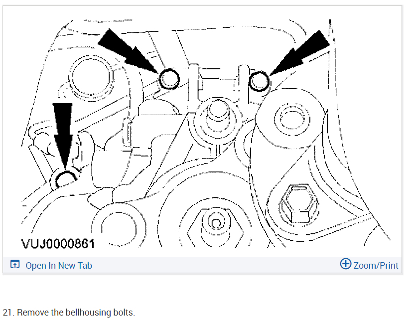

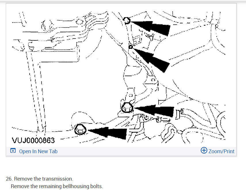

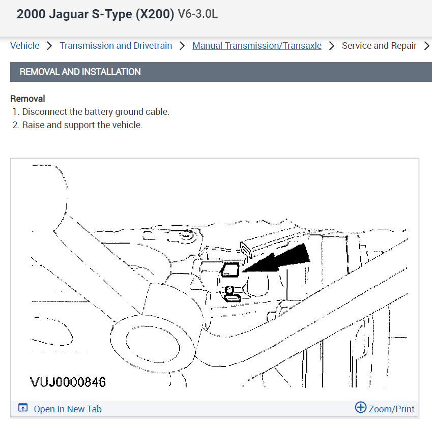

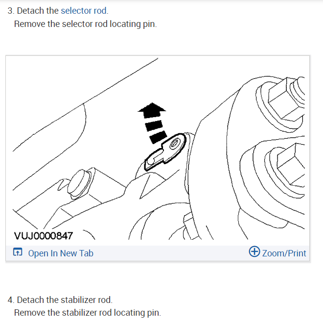

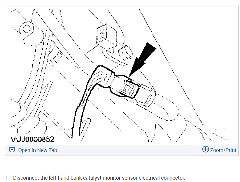

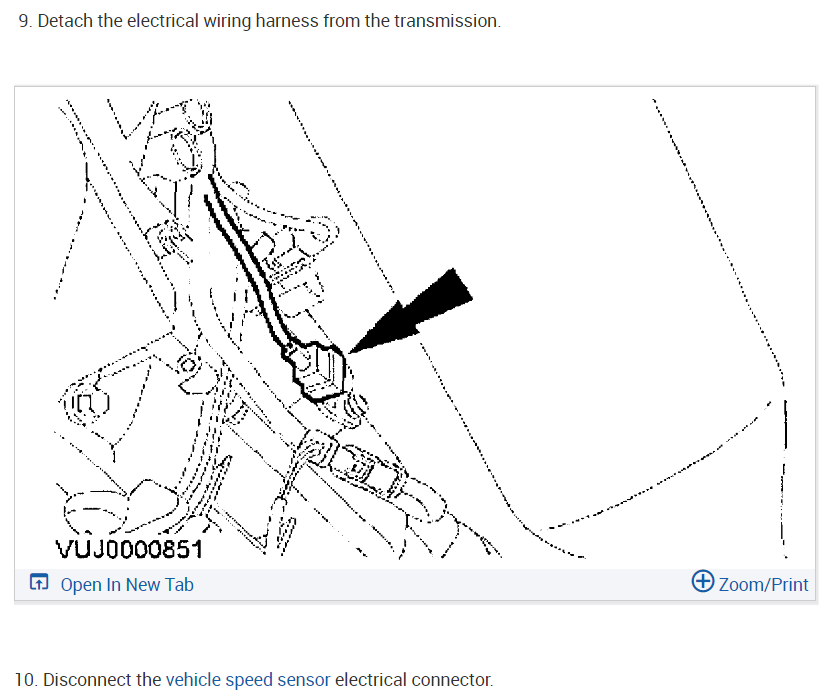

Yep, the new clutch they installed is bad or the clutch fluid leaked unto the clutch disc either way it need to be replaced again. Here is a guide and a video to help you get the problem fixed.
https://www.2carpros.com/articles/how-to-replace-a-clutch
Here is a generic guide to help you step by step with instructions in the diagrams below to show you how on your car.
https://youtu.be/JpzefqEeVGE?si=KbKNtkMi70TKEJLk
