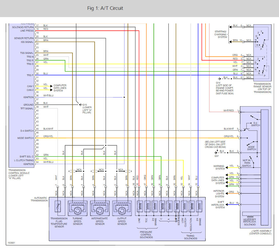

After topping up the geabox of my 2003 Jaguar x-type the car would not reverse.Oil level is correct level
Nov 16, 2008 at 8:59 AM
  • 55,433 POSTS

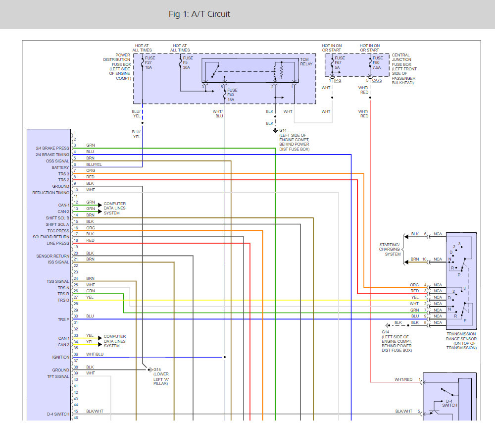

It sounds like you have a reverse shift solenoid that is not working. Here is a wiring diagram and a few guides to help us test and replace the solenoid. Also a transmission range selector switch can cause the problem as well.
You will need to remove the pan
Here is a guide so you can test the switch
Here is the wiring diagram (below)
