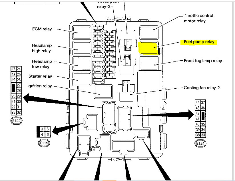

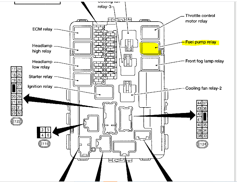

I need to know what was done to bypass the fuel pump. I suspect you mean something was done to the wiring, but I need confirmation.
Let me know as much as you can. And yes, there is a fuel pump. I attached a pic below of its location in the power distribution module. Let me know if that relay is still there.
Also, if you could take a few pics of what was done, hopefully, it will help me determine what was done.
Take care and let me know.
See pic below.

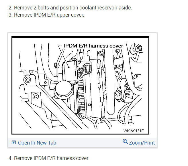

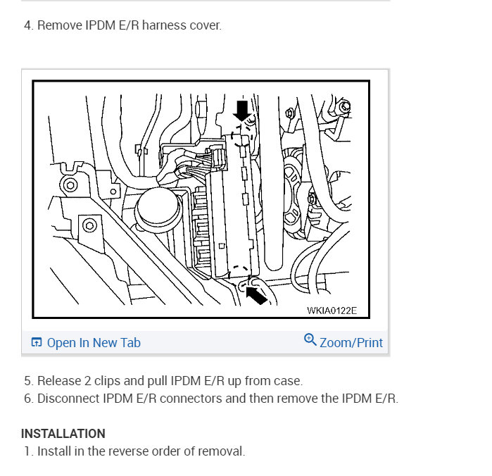

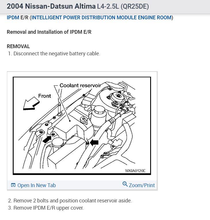

Does the check engine light come on with the ignition key? These cars have an IPDM which goes out and can cause all of the issues you are having. We should do a CAN scan to confirm you can get a CAN scanner (Controller Area Network) from Amazon from about $32.00.
https://youtu.be/u-4syLc-ifQ
and
Amazon CAN scanner Link.
https://amzn.to/3G7mpFP
Here is how to change the IPDM out in case you need it. It is easy to replace because it does not need programming, it-self learns. I hope you are your doggy's are okay. Check out the images (below). Please let us know what happens.
