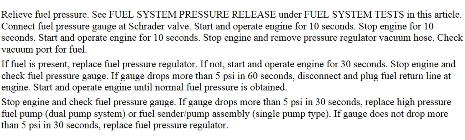

I have a fuel pressure of 50 psi when the Tempo is running (runs great- no loping etc.) and when I shut off the engine the pressure goes immediately to 0 psi. I suspect the fuel regulator or rather the valve within it (presuming it has a mechanical valve as there is no electrical plug going to the regulator) is failing. I have looked the entire length of both the fuel supply and fuel return lines and I do not see any leaks anywhere. The pressure should be holding long after the engine is turned off.
So my important question is…
Where would you suggest looking for the problem of pressure loss?
Aside from the Fuel pump in the tank… are there other valves in the fuel line circuit that hold pressure in the circuit?
I performed the Regulator test that they suggest in the “Haynes” repair book – and the pressure does increase to about 60 psi with the vacuum hose off and plugged, which they suggest is an indication that the Regulator is not the problem.

check the regulator it should hold within 5 psi for a few minutes yours may be int eh tbi unit if yo have that

it should be the because I'm old the keyboard doesn't always co-operate with my fingers. it should be 45-60 psi with engine running and without running it should be50-60 but that doesn't test when you shutdown. TBI units look kind of like a carburetor check yoru crank sensor it should be 210-250 ohms its'in distributor in pic is proper way to test pressure regulator. if you are sure it's fuel it shold drop more than 5 psi in 60 seconds bu t that wil show you how to test it.

I'll try plugging the return line or simply change the regulator (as I'm pretty sure it isn't the pump). You hadn't mentioned if this is the only valve in the system.
Is It?
The attachment you sent;
ie: plugging the return line to see if the pressure drops,
sounds like a good test.
Presumably I shouldn't plug it for too long as this would cause back pressure in the supply line. Correct?

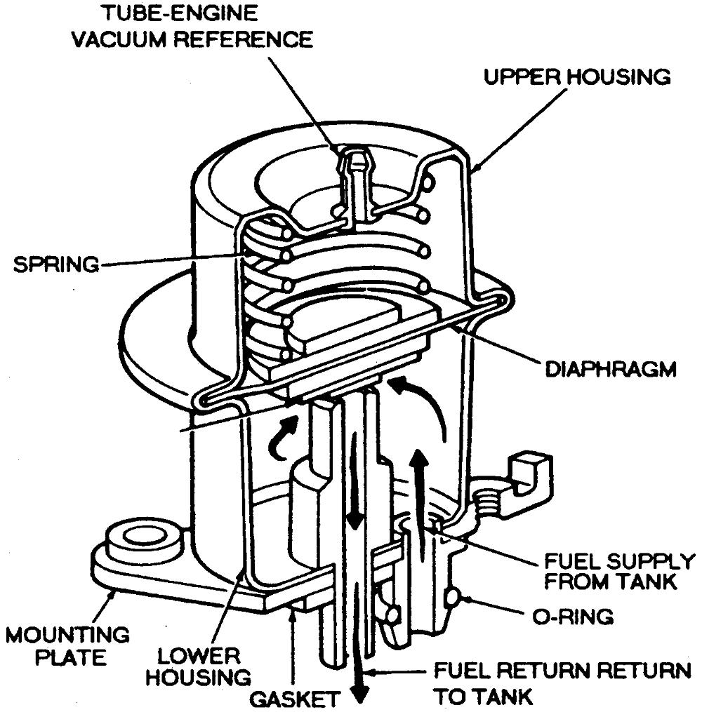

I came across an image before I received your reply (which I will try to attach here) which led me to believe that the problem could be a weak spring in the regulator which would explain the loss of pressure after the engine (and fuel pump) have stopped. this would explain why it would take so long for the gas to reach the injectors.

it is probably the only valve in system other than one in pump maybe. that test is to scheck pump and regulator.

So I replaced the regulator with a good used one,
(rather than try and make something to plug the return line) and the pressure still dropped to zero immediately after I shut the engine off.
I then plugged the return line as you suggested… The pressure increased to 75 psi and stabilized (toke 10 seconds), so I turned it off and the pressure still dropped to zero immediately.
If this also tests for the pump as you say, then I must
have an internal leak somewhere.
Is this right???
Any checks that you can suggest??

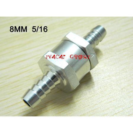

I know the pump only has 20,000 km on it, so I'm probably going to live with the inconvenience of cranking it 2 or 3 times to get it started.
Once started, it runs fine.
I was thinking of putting in an inline fuel check valve.
I phoned local auto stores; they don’t sell.
I looked online and found some (see picture), but they don’t specify a pressure rating which I would like to see.
My only concern about doing this would be that I may be creating an air pocket between where the check valve is installed and the tank’s pump.
What are your thoughts?
A) Where can I get a check valve for fuel?
B) Air pocket concern?

it's not worth the money or time to put that in your system,it's more trouble than it's worth. I can't answer any more due to being away from home computer and won''t be back until end of month . probably what is really wrong is car is old and pump is weak causing this and just put up with it until it fails completely. if you aren't satisfied with this answer then repost and another mechanic will answer
