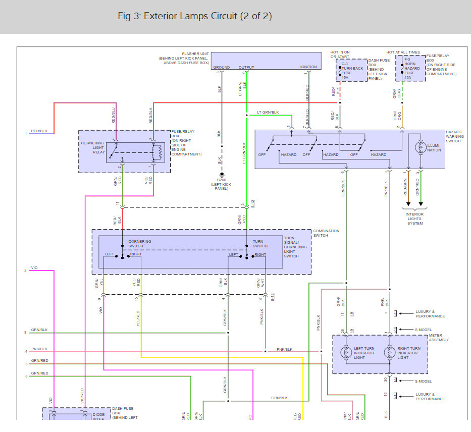

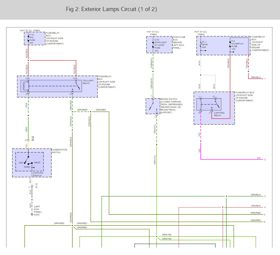

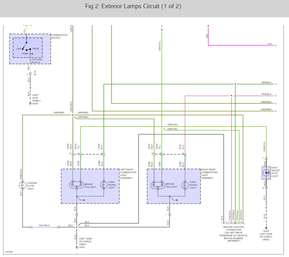

My driver side rear brake light does not work when I push on the brake. It will come on when I unlock my vehicle ( it blinks twice) with the remote and when I have the parking brake on but if I am driving and I stop it does not come on. The other brake lights work fine. What could be causing this and how can I fix it?
Jan 17, 2008 at 12:15 AM
MERLIN2021
  • 17,250 POSTS
It sounds like you have an aftermarket alarm that has gone out. Here is a diagram to show you the brake light wiring and a guide to help you test for power.
