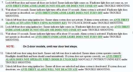

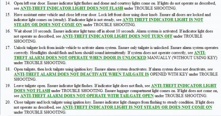

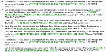

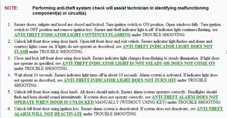

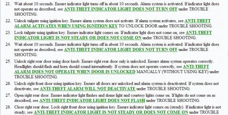

Here's some further info...let me know which test you need after checking this out...
https://images.2carpros.com/forum/automotive_pictures/62217_Test1_1.jpg
https://images.2carpros.com/forum/automotive_pictures/62217_Test2_2.jpg
https://images.2carpros.com/forum/automotive_pictures/62217_Test3_1.jpg
https://images.2carpros.com/forum/automotive_pictures/62217_Test4_1.jpg
https://images.2carpros.com/forum/automotive_pictures/62217_Test5_1.jpg

Door locks are tied into the anti-theft system....if the module has a problem, it will show up in some action performed with the remote....
