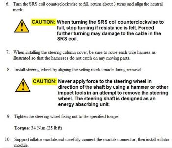

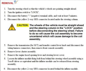

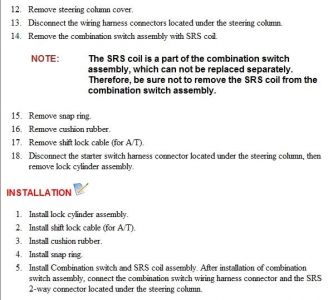

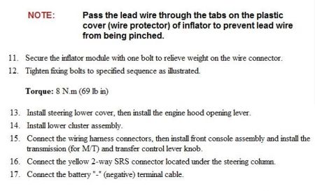

What is the procedure to change only the ign.key cylinder.Key gets stuck in ign.sw.

https://images.2carpros.com/forum/automotive_pictures/261618_Noname_1973.jpg
https://images.2carpros.com/forum/automotive_pictures/261618_Noname2_637.jpg
https://images.2carpros.com/forum/automotive_pictures/261618_Noname3_250.jpg
https://images.2carpros.com/forum/automotive_pictures/261618_Noname4_126.jpg
https://images.2carpros.com/forum/automotive_pictures/261618_Noname5_54.jpg
