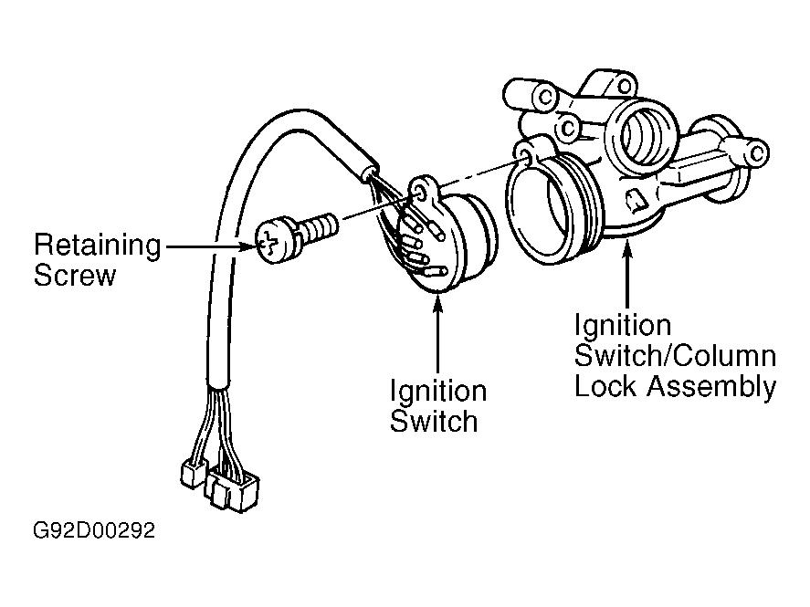

i lost my keys and need to change the key lock cylinder
1991 ISUZU TROOPER
140,000 MILES • 2.8L • V6 • 4WD • AUTOMATIC
AURORADIANE
I've got a screwdriver in the keyhole to unlock it, but that's as far as it will turn.
So i removed he switch from behind and I'm using another screwdriver to turn the truck over.
Now I need to get the tumbler out so that I can replace it, but don't know how to get it out.
Can someone please tell me how to get it out?

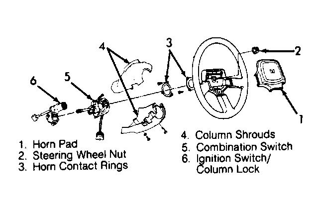

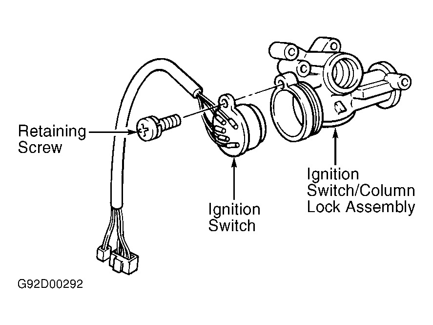

NOT THE EZ TASK YOU HOPED IT WOULD BE!
MR. LOCKSMITH MAY HAVE BEEN THE LESSER EXPENSIVE ROUTE BEFORE THINGS GOT CHEWED UP
OK
1ST PIC - REMOVE 1,2,3,4s TO ACCESS 5 AND 6
2nd PIC - SORTA SELF EXPLANATORY
HOPE THIS HELPS
GOOD LUCK!
RETURN WITH GOOD NEWS
DIAGRAMS BELOW
