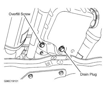

Six cylinder four wheel drive automatic 157,800 miles.
How to add transmission fluid to my vehicle?
May 7, 2010 at 12:11 PM
MHPAUTOS
  • 31,937 POSTS
Hi there, There are two plugs on the transmission pan, the lower is the drain the upper is the over flow check, the oil is added her until it run out the same access plug, this is done with the car level and is easiest done on a hoist.
