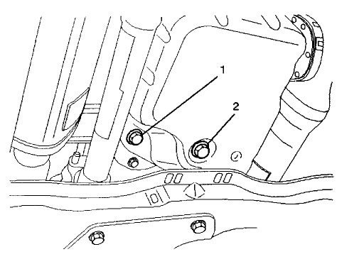

I need to know how to check the transmission fluid
1999 ISUZU TROOPER
190,000 MILES • 6 CYL • 4WD • AUTOMATIC
ANTOINE CORRALES
How do you check the transmission fluid?

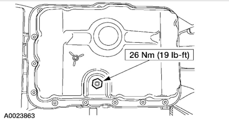

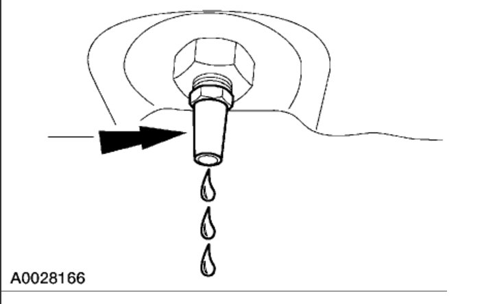

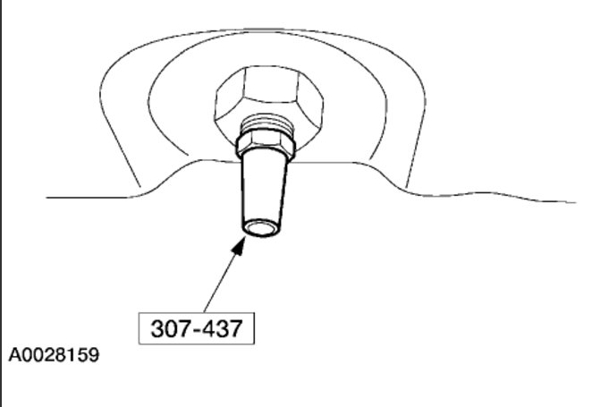

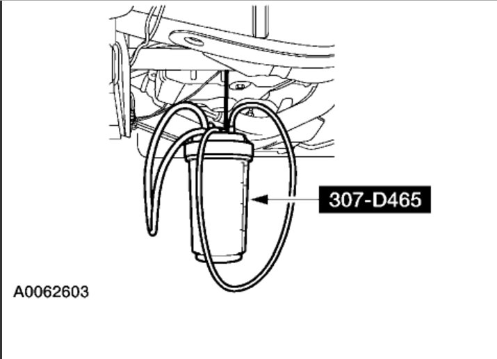

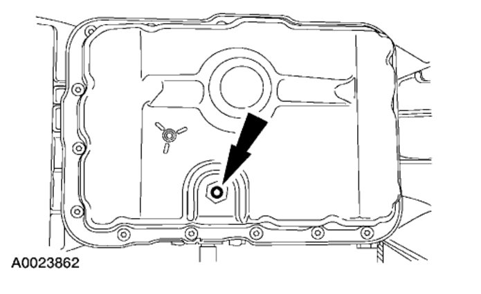

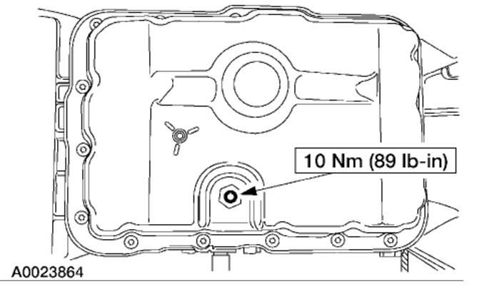

Number one on picture is the transmission check and fill hole. If you want to check it yourself, place a catch pan under the pan. Warm up engine and fluid should be between 90 and 135 degrees. Remove plug number one. If fluid over flows or drips a little bit, you are full. If no fluid comes out pump Dexron3 with a pump. It will get messy.
