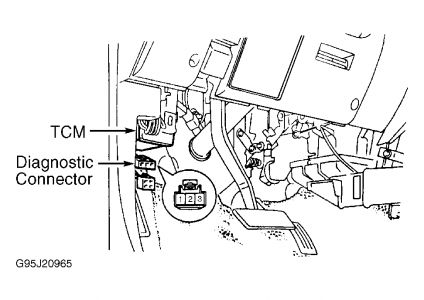

Scan the transmission control module for code/s-
Wednesday, December 4th, 2019 AT 3:59 PM (Merged)
CHIEFS30
Thank you where can I locate the control module to scan for the codes on the vehicle
  • 75,992 POSTS
TCM Behind left side of dash, above kick panel.

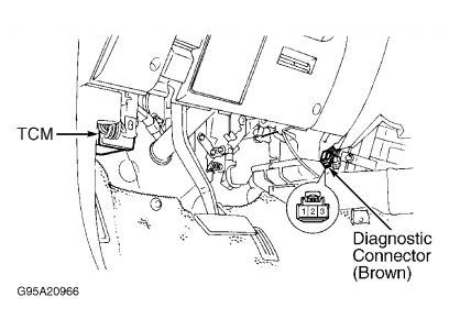

2CARPRO JACK
  • 11,533 POSTS
It means the computer is seeing a problem witht hetransmission.You can hav it scanned with ascan tool or you can install a jumper wire from terminal 1 to terminal 3 in the data link connector (see pics)
https://www.2carpros.com/forum/automotive_pictures/1639_isuzu1_2.jpg
https://www.2carpros.com/forum/automotive_pictures/1639_isuzu2_1.jpg
Then turn key on, the trans light will flash the codes. It will start by flashing 12 3 times to let you know it is in diagnostic mode.All other codes will follow.The comp will flash each code 3 times, then move onto the next one.
